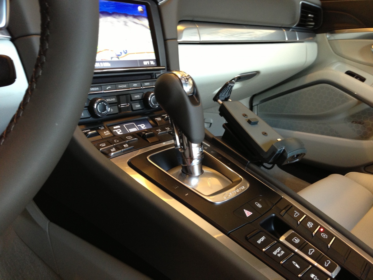

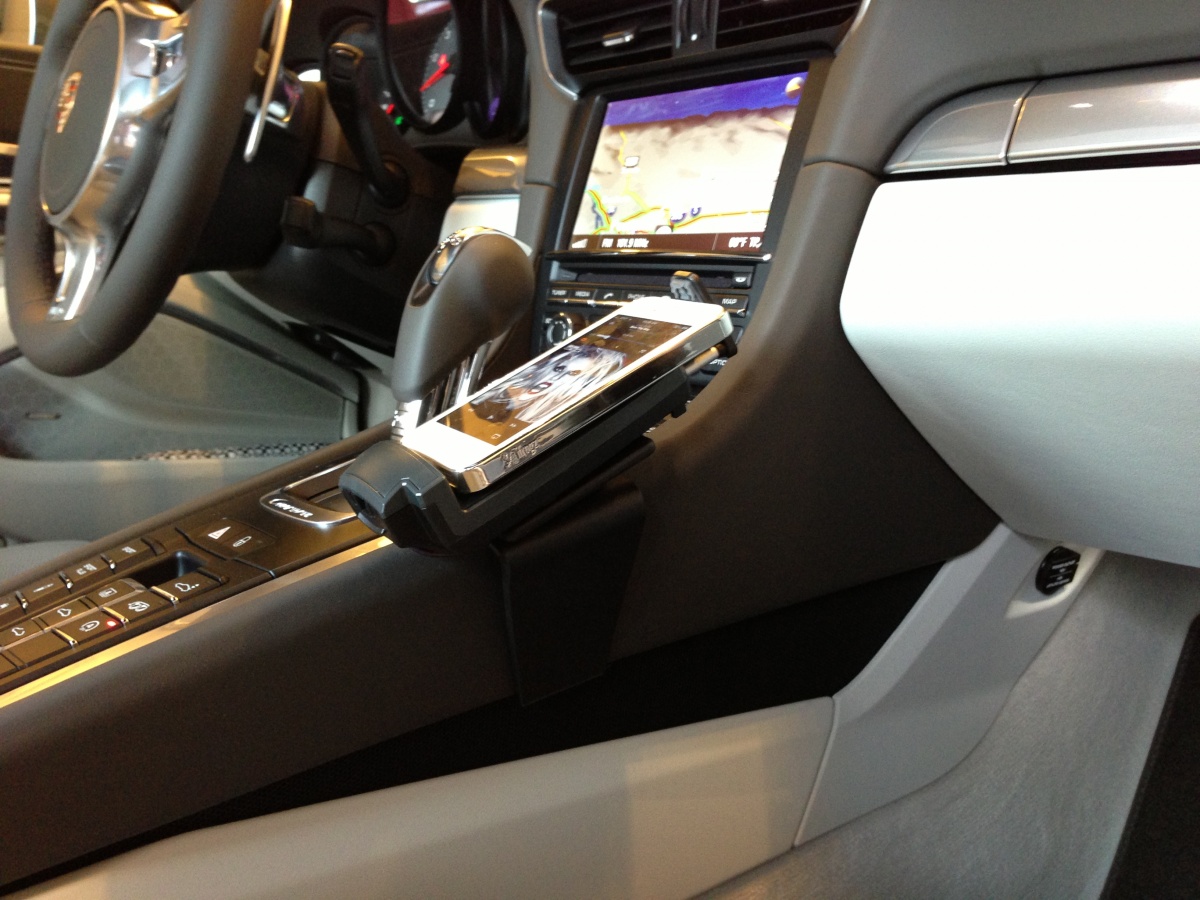

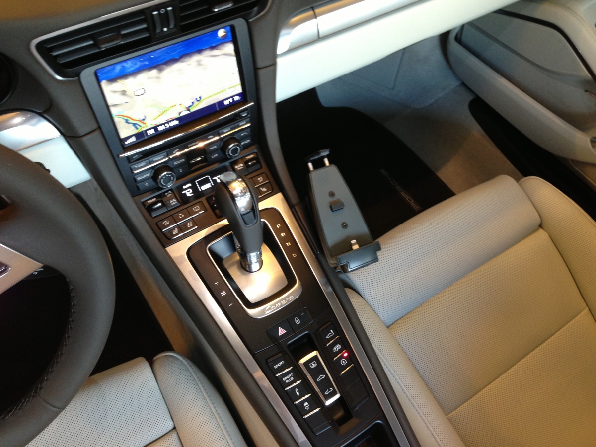

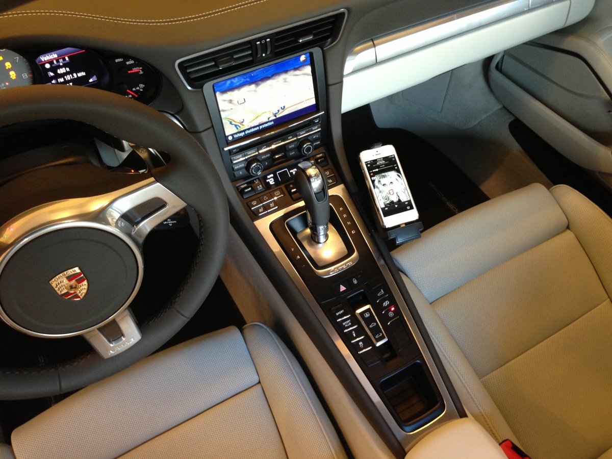

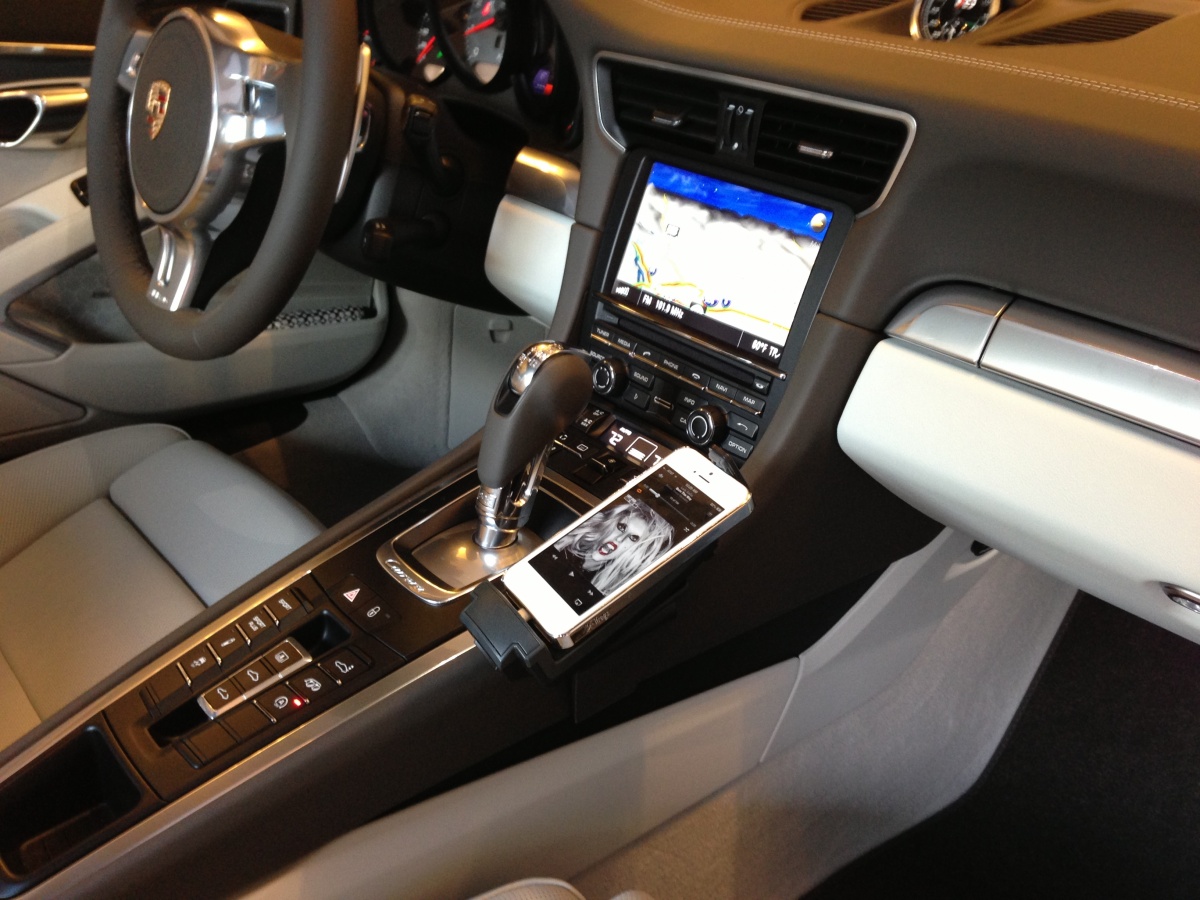

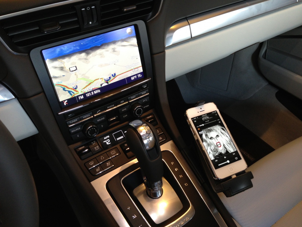

This is a ProClip Console Mount #834878 that is attached to the right side of the console.
Custom-fitted attached is an iPhone 5 KUDA iMega CradleMount #21158 that accepts the Apple Lightening cable. The wire is run underneath the trim panel along passenger side of the console and into the glove box USB port.
It does NOT interfere with the passenger's left leg.

TTCarrera - nice set up... Given me a few ideas. Can you take a picture of the cable run? I would be interested to see where you ran it.
You want me to take it apart, to show you where I ran the cable?
Really?
Can I try to describe it instead?
See photo below. First, carefully drill a hole in the side of the drop down glove box near the USB jack, just big enough for the Apple Lighting plug to fit through, then plug the other end into the USB jack.
Then, mount your holder & connect the cable.
OK, see the bottom of the ProClip mount? At the horizontal seam where the Agate Gray leather panel overlaps the black vinyl panel? Tuck the wire up in there. Follow it to the right, all the way to the end of the panel, under the dash. Right there, you are 3 inches away from the USB jack in the glove box. Leave enough slack to raise/lower the box so the cable doesn't jam or pinch and then stuff the excess cable up under the seam.
Very simple.
