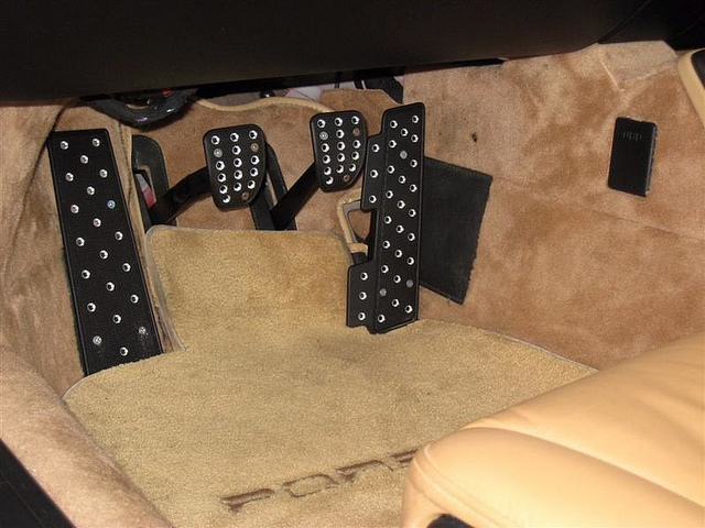

You dont think the Rennline type gas pedal with the extensions will work?
I have the whole set and like them, even thought I cant use the side foot method of the heel/toe with them. ( I use the traditional twist of the foot to use the heel method)

Yes...i like them...good quality. I have the lifter plate and have adjusted it to make heel toe easier.

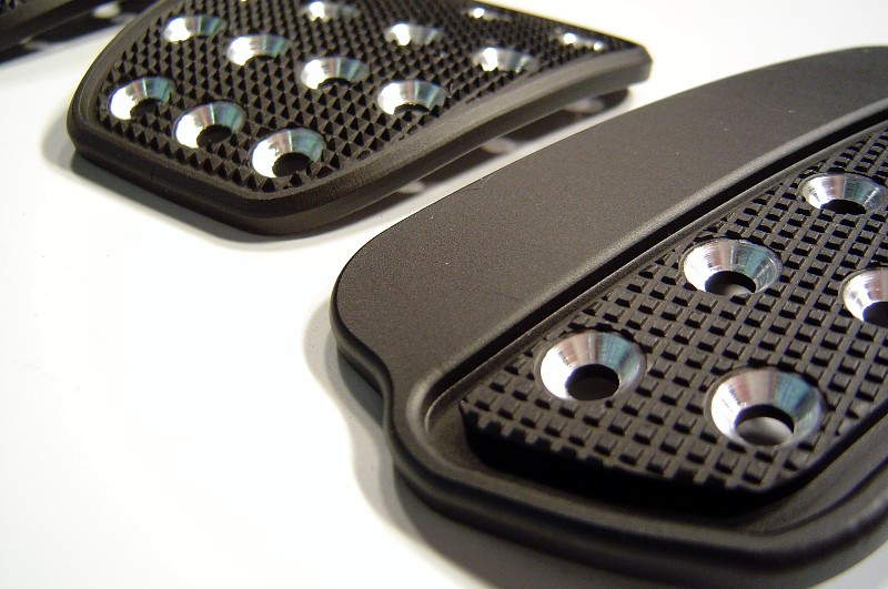

I'm sure both are great options. I have the SRP-Racing pedals on order myself, but the 2012+ 991 version. Placed order a few weeks ago and hoping they come soon:
http://www.srpracing.com/pd-991-2012...ing-pedals.cfm
with these options:
Manual trans
Grid finish
Black/Silver
Double heel/toe extension
here is a pic of the single heel-toe extension with those options:
and here is the double heel-toe extension (but not the specific 991 product):
(plus a neat video of how they are made. Great quality stuff.)
