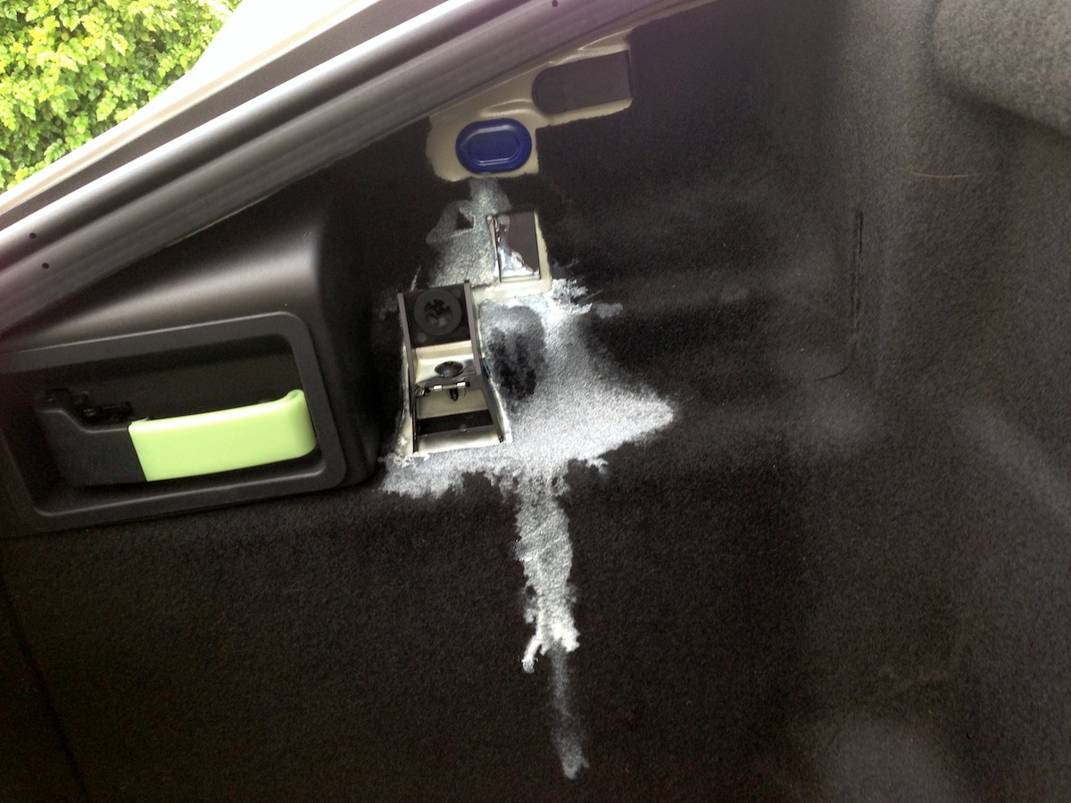

For some reason, my tire repair kit decided to explode during the past 24 hours, leaving sealant all over the place (see photos). No apparent reason--it's actually kind of cold these days in northern CA, between 50 at night and 70 during the day.
Does anyone know how to clean up the mess?
Also, did this happen to anybody else or is this just a freak accident?

Wow. That is not what you want to see when u open the hood. I could see maybe in a really hot environment, but 50's should not cause that type of reaction.
Never seen this before
Do not waste your time cleaning up the mess, bring the car to the dealership, they have to fix it and replace the lining if they can not get it perfectly clean (may be hard to completely remove the sealant...)

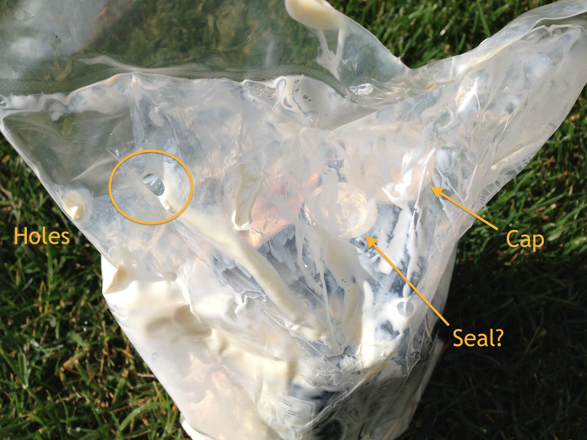

Update: took a closer look and it appears the cap of the bottle came off and the plastic below is actually not a seal but has an opening. So a fair amount of sealant escaped from the bottle into the plastic sac around the package. Unfortunately, that sac has a few holes by design, so that's what ultimately ruined the lining. The white stuff rubs right off the plastic and styrofoam of the lid, so it's just the lining I suppose.
Anyway, called the dealership since I need to get a few things fixed anyway (rattles, brakes squeaking, door adjustments, etc.).
But the learning here seems to be you may want to check your kit from time to time to see whether the cap has come undone or loose.

Here's the Mod, using a standard bottle cap:
Before:
After:

TTTerriffic! Thanks for this inventive idea!
Also I didn't know the cap is off by default. Seems like the seal should really be a seal but somehow came loose in my kit...
