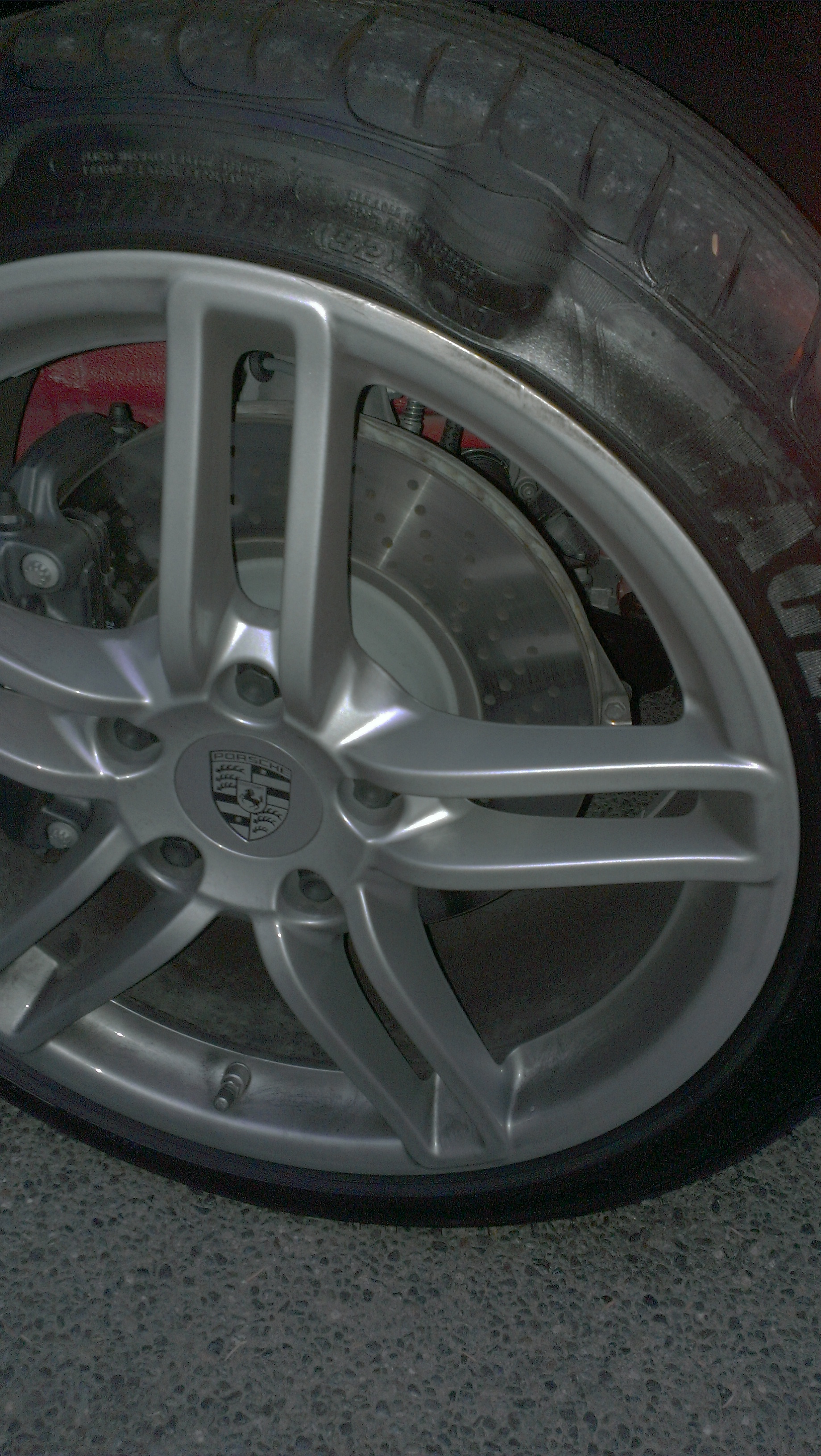

car is 1 week old, I have only put on about 300 miles and driven less than a dozen times. today coming home from dinner with the family i hit a fricken pot hole. car drives fine...no alignment issue and no rim damage, just a few scratches on the bottom side of bumper, but i've got a bulging side wall.
i have the 19" goodyear f1 235/40/19 on the front...do u think this will be covered under warranty from the manufacturer?
i did not buy the wheel/tire hazard warranty at the time of purchase...do u think since it has only been a wk i can buy from the dealer?
i bought some h&r springs to lower the car in a few wks...maybe it is not a good idea with the roads in washington and the way i drive.
i can't believe this...

This is a common occurrence with low profile tires. Your dealer might in good faith sell you a replacement tire at their cost. Unfortunately, manufacturer 's warranty doesn't cover damaged sidewalls.

Also - you'll want to get that fixed ASAP, the next step is a blow out and that is no fun.

Had the same thing happen to me and though there was no visible rim damage, turned out the hit was hard enough to cause the rim to be slightly out-of-round. Couldn't eliminate steering wheel shimmy until the rim was replaced with the tire.

What pothole? I didn't see a pot hole.
Did you actually stop the car and inspect the wheel and tire immediately after you allegedly hit a pot hole? I doubt it. Looks like the tire just failed and such failure is a warranty covered event. Take it to the dealer.

exactly....u was just washing my car and notice the tire bulge. WTF

I had the same issue but dealer didn't buy any story about defective tires. Had a buy a new one. Dealer's prices are competitive with Tire Rack.
At least you didn't have a damaged rim, that would be much worse.

Sounds like a defective tire. The tires on my trusty and elderly Honda van were recently replaced by the vendor as all were "out of round" due to defective belts.
take it back to the dealer, oh and go into your glove box and open and read the warranty provided to you by the tire manufacture before you speak with the dealer...it always helps to show them a photocopy of the warranty with the pertinent parts highlighted in yellow.

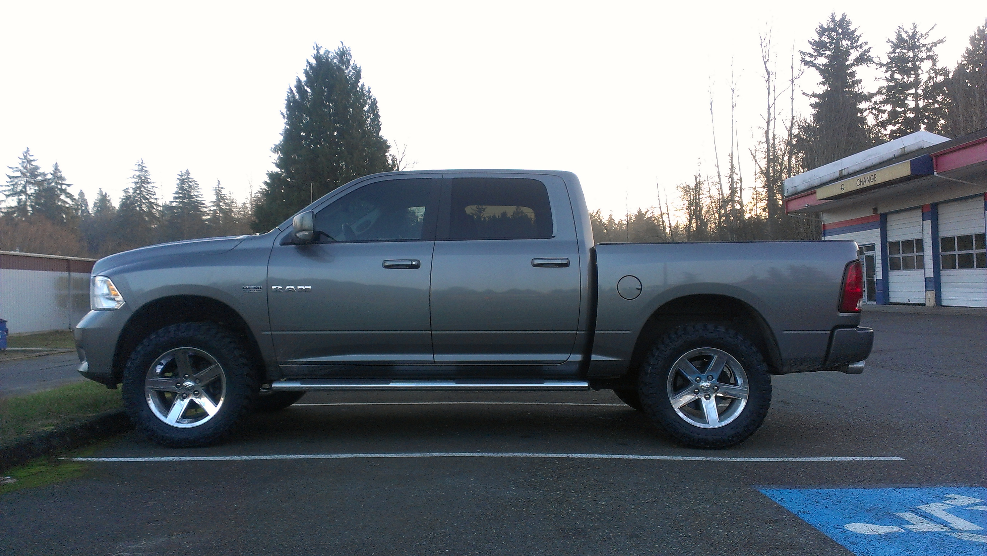

this is what i'm used to driving. this has been my daily driver for 3 years...still have the truck, just wanted something fun
Name:	2013-01-17 16.14.30.jpg
