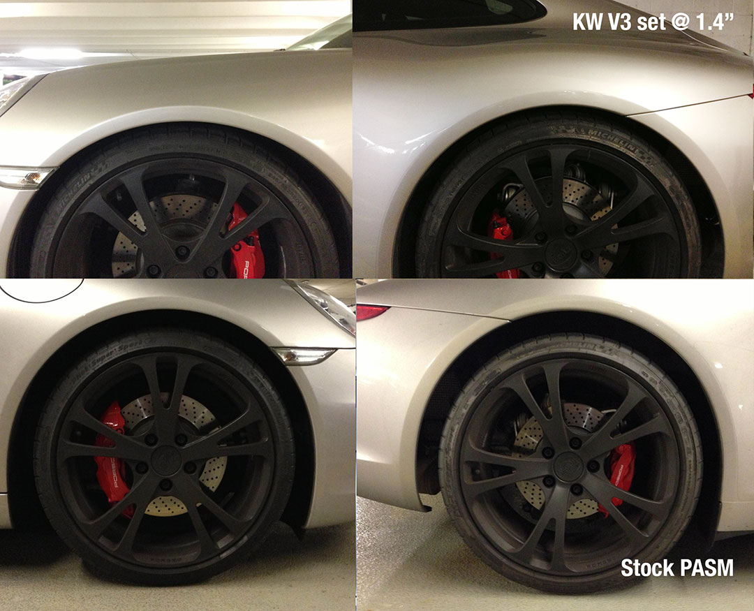

Got the car back today from Scan Automotive, they did a fab job on the car, everything is dialed in pretty good and their attention to detail and service are superb. Thanks again James and his crew at Scan Automotive in Vancouver BC. They had a huge selection of sick cars they are working on at the moment.
Visually the car look SO much better
This is my 3rd car with KW V3 installed, alway had superb experience with them and never look back on other brands in terms of comfort and adjustment for part time track junkie like myself.
At the moment everything is dialed at 60% max stiffness and lowered 1.4" all four corners and corner balance to my body weight.
Front Camber set at -1.85
Back Camber set at 2.07
First driving impression:
Steering feel heavier and feedback better then before.
Ride Comfort is comparable to PASM set to SPORT mode. With the V3, it came with a PASM bypass module, the PASM button doesn't work any more.
Turn-In much quicker and more stable then before
I swing by a few 40KPH hair pins by YVR airport, I can take these turns easily 15mph+ faster and still not reach the limit yet. Its getting dark so didn't want to push my luck and with my loud FVD exhaust don't want the cops to pay me a visit.
Have to take a few fast laps at Cypress Mountain tomorrow to see how the car perform under heavy fast load transfer
Overall VERY impress by the build quality and ride comfort and increase feedback I got from this setup. Going to play around with the setting this weekend and fine tune it to my preference.
Highly recommend it to any 991 owners looking to take the car handling and steering to another level.
I'll add in more feedback and comments as I put more miles on them

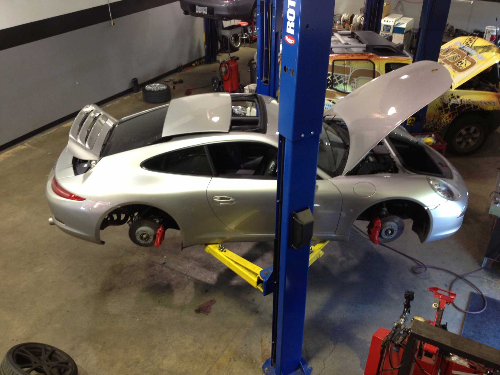

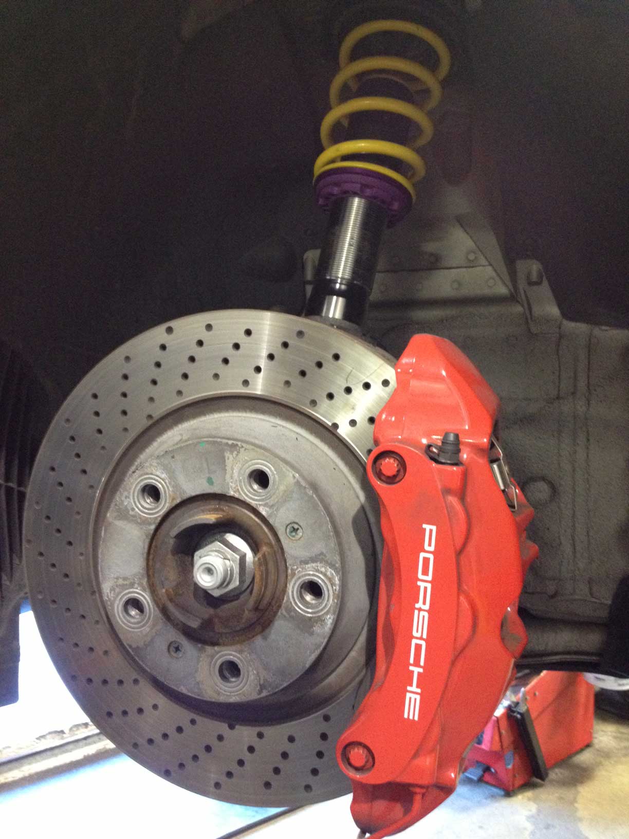

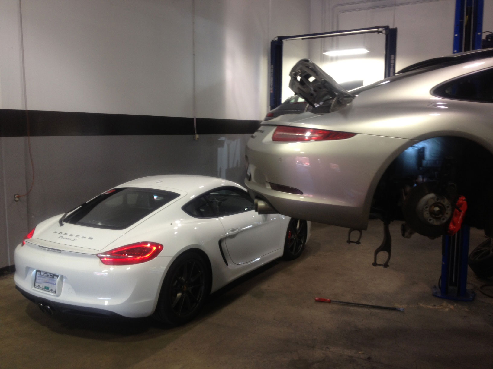

Now on to some pictures
ID:	269171   Click image for larger version
ID:	269172   Click image for larger version
ID:	269173   Click image for larger version
ID:	269174   Click image for larger version

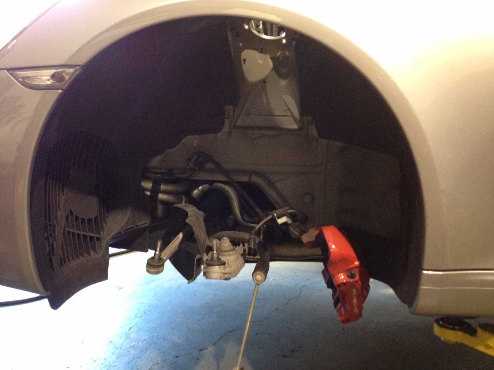

more pics
ID:	269176   Click image for larger version
ID:	269177   Click image for larger version
ID:	269178   Click image for larger version
ID:	269179   Click image for larger version

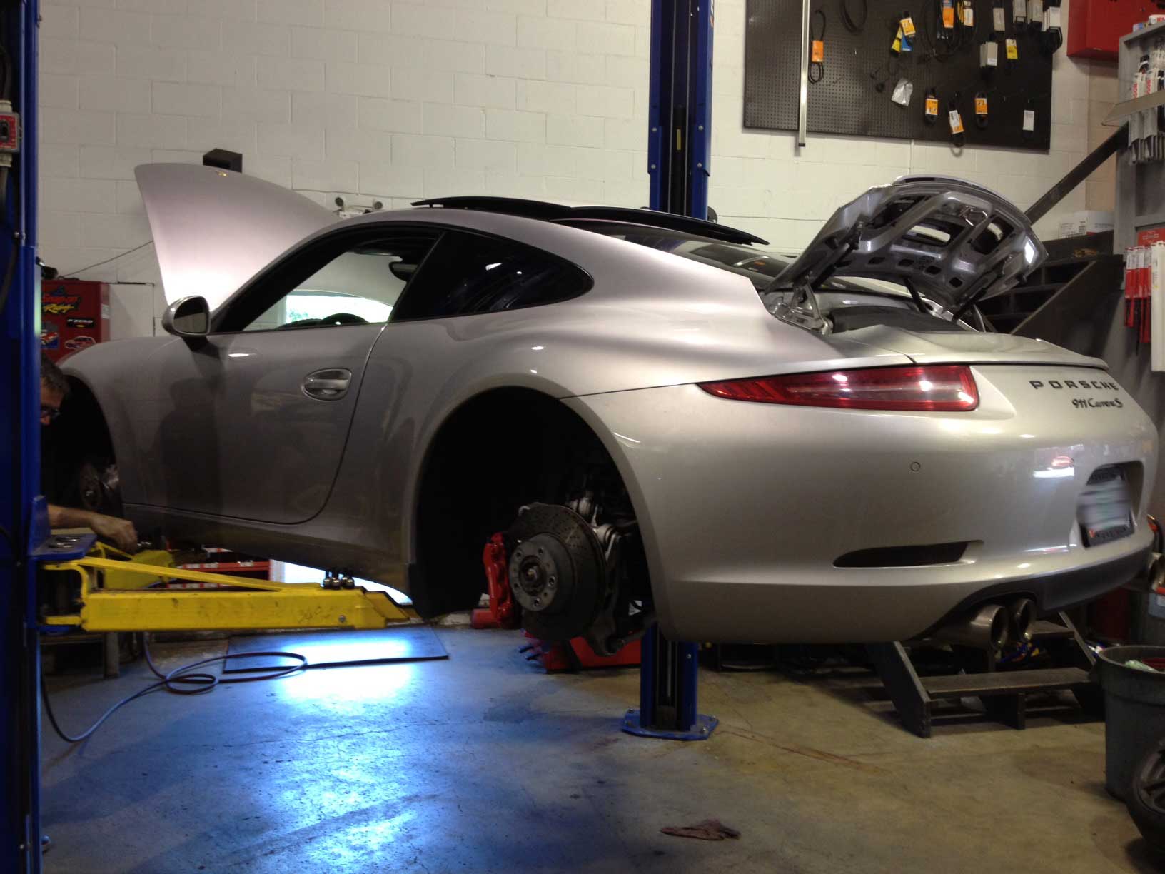

last one
