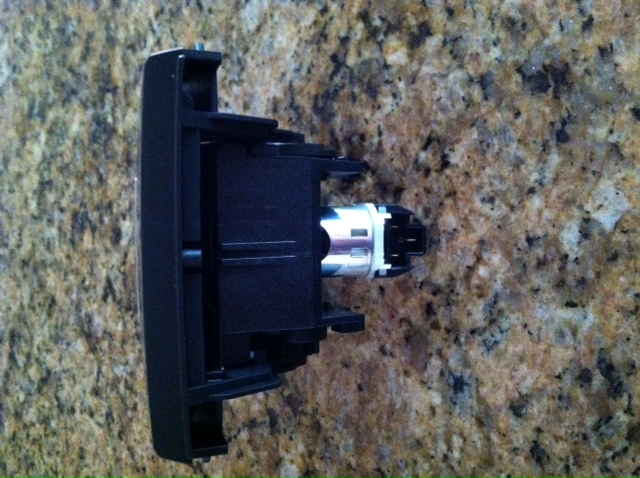

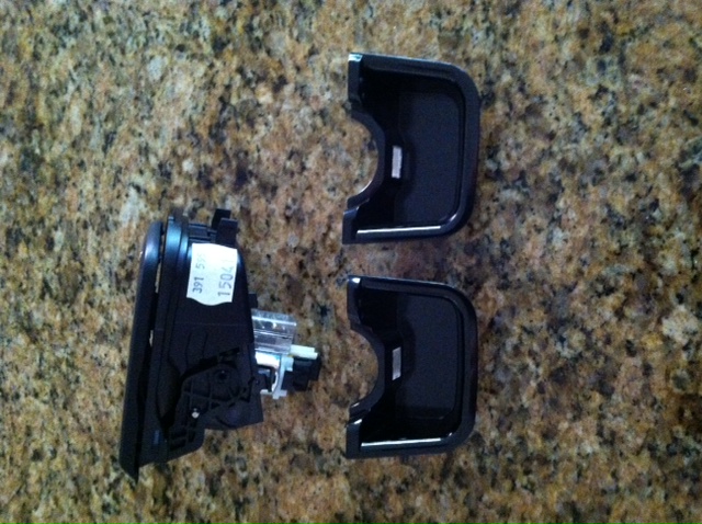

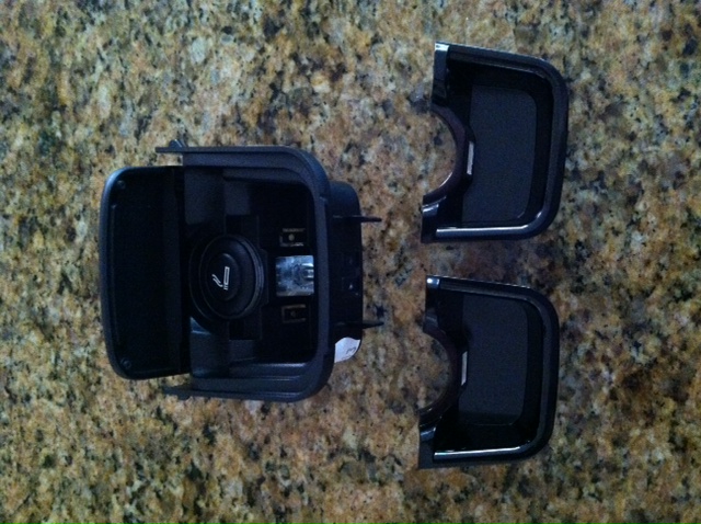

Attached are a couple PICs of my new ashtray. I gotta say it's a very nice ashtray but $200+ is a bit much. I didn't like the coin tray since it's almost useless so I bought the smokers package for a clean look and to also hide my subwoofer control ****. I didn't think it came with the insert so I ordered that too, well it did, so I wasted an extra $28.
I heard someone else say the dealer wanted charge a large sum to install it. I haven't checked with my dealer yet, so hopefully it isn't too much. Doesn't seem like it would be too hard to disassemble the center dash. I may try it myself, but I'm a little afraid of breaking a plastic piece because I know the replacement would be expensive.
If anyone already knows the procedure, it would be greatly appreciated.

Just got my car back and decided to look into the center console removal. While at the dealer, I had them give me a quote for the install, they said 2.5 hours of labor (approx. $400). I would say this is about right if you know the proceedure to disassemble the dash and install new wiring. This is not prewired from the factory.
If you only want the ashtray installed without power, this would be a 10 minute job. If you do want the power, then add a 2-3 hours of work. Mine was a little more complicated since I added the subwoofer level controller inside of my ashtray.
I'll write a more detailed DIY in a new post.
Basic steps just for removing/replacing coin/ashtray:
1 Open center console
2 Pry up Silver trim starting from the console compartment moving towards the front. I was able to do all of this with just my fingers. slowing lift up and go back and forth from right side to left side then back to right continuing toward front of car until it's removed.
3 remove rubber grommet that was under the silver trim
4 pull up on plastic surrounding the shifter, just needs to be lifted a little, not removed from car
5 pull on next section where all the buttons are located. This has three wires attached and can be left to the side, but unplugging isn't necessary.
6 push forward (towards front of car) first then slightly upwards on the coin holder to remove
That's it, I was done in less than 5 minutes.
Install in reverse order.
If you want it wired with power, then it gets more complicated. I tapped the wires with Posi-products "tap-it" leading into the outlet in the center console compartment. This required compete removal of back seat and complete disassembly of the center console and trim. I'll write up a more detailed DIY for all that. I didn't wire up the little light since I didn't think it was necessary for my needs, I only wired the power outlet.
