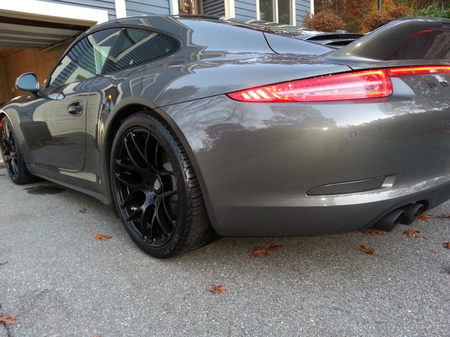

Originally Posted by bpatel23
Which wheel/tires set worked for you on your 991 C4S?
I ended up going with these in black:
https://www.6speedonline.com/forums/...uger-mesh.html
I went with PA4's. +52 in the rears is stock but they recommended +40 which fit perfectly with no spacers.
The quality of the wheels is good and the price was right for a set of winters.
Here's a quick shot:
Thanks for the quick response. Did you buy your set from http://www.getyourwheels.com/? Did they put in the TPMS as well? What should I be looking at for a total cost?
Sent you a PM.
