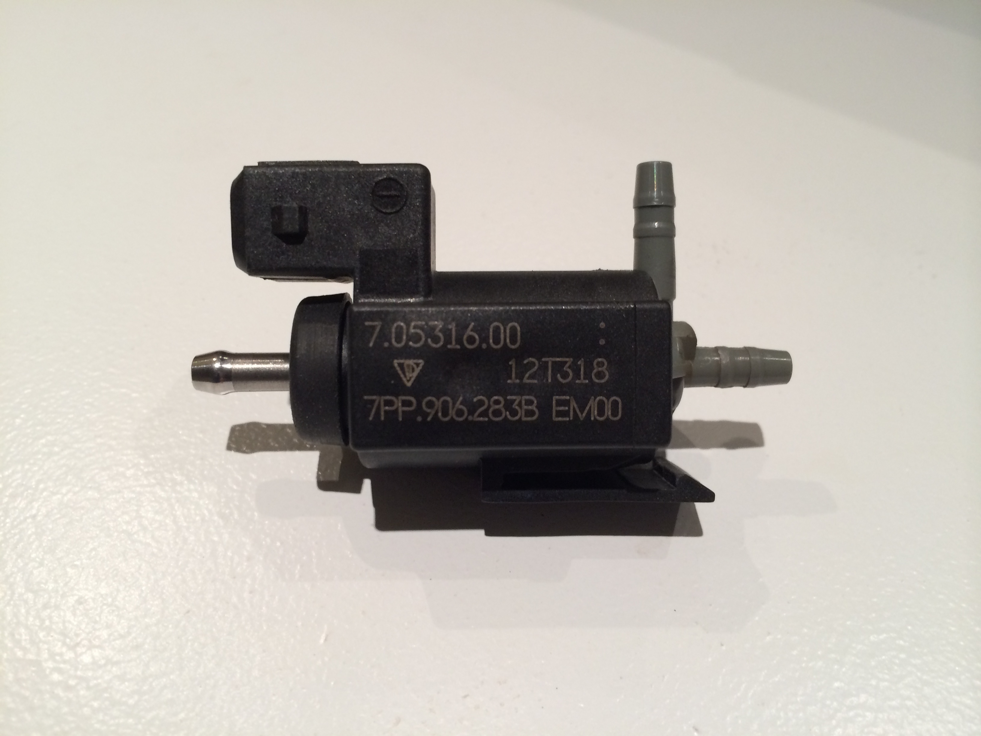

I recently posted about a failure of the vacuum lines controlling my sport exhaust. After investigation it had turned out that I had (at least) 3 change over valves that had failed. Now check this picture and the part number:
With the exception of the last character (C instead of B), this is the exact same part number. Checking on a part supplier website, I saw a comment saying that 7PP906283C was a new part number for 7PP906283B, so we are in fact talking about the same thing.
I asked my dealership about this last week and they told me that there had been a recall campaign for early 2012 builds. Mine was a late 2012 build and your C4S is a 2014 model year. This basically means that Porsche has an ongoing issue with this part made by Pierburg.
I find it somewhat disturbing as it looks that there is a lingering issue that does not seem to be properly taken care of. Similar change over valves (from the same supplier) are being used by all car makers, and by Porsche on previous models. Why can't they figure this one out
