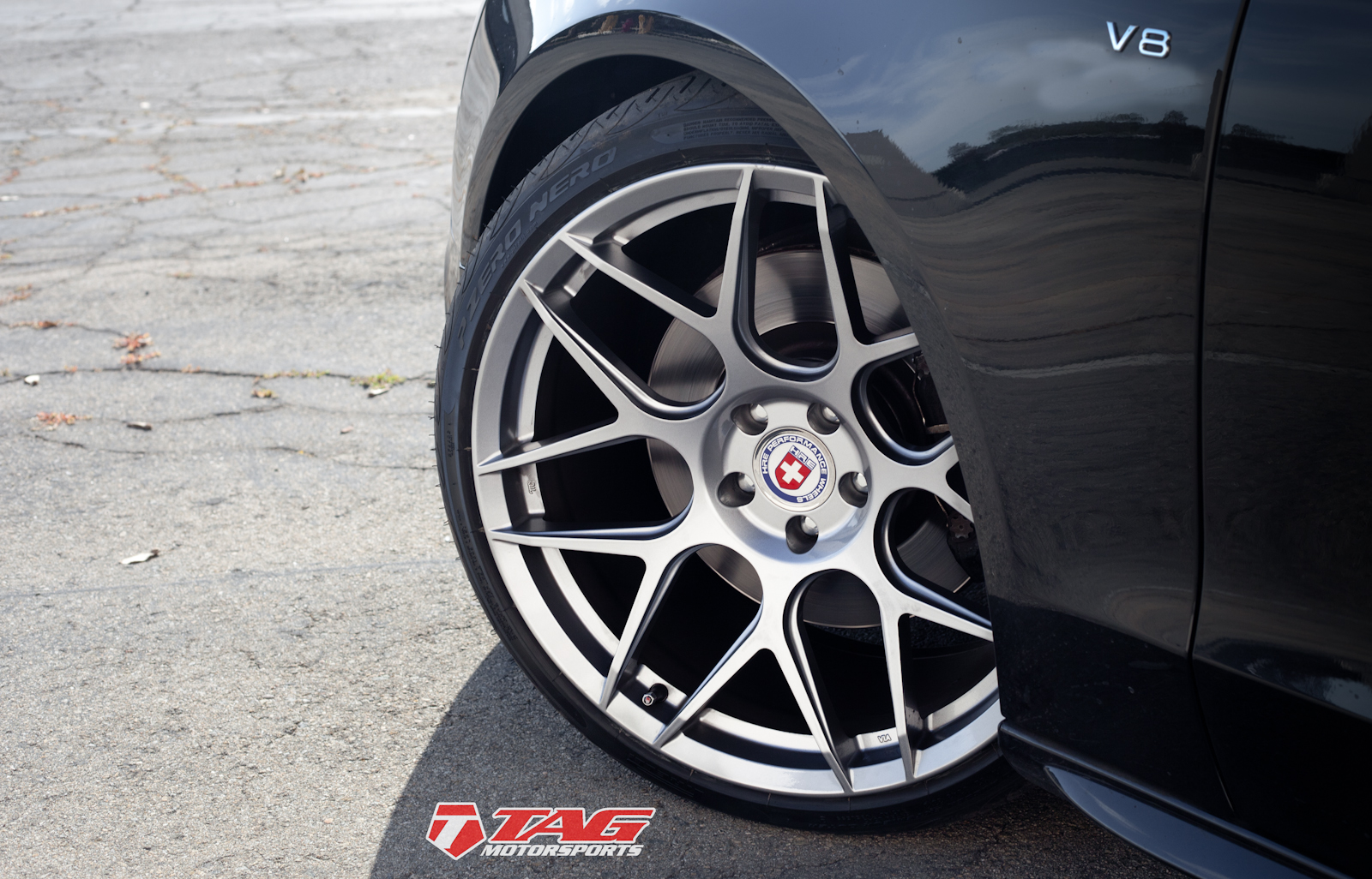

I have the 5mm spacers on both front and rear. I think both wheels will look great. I am liking the Vorsteiners for look and like the HRE's because they are HRE's. Not fully on board yet.
HRE
Vorsteiner

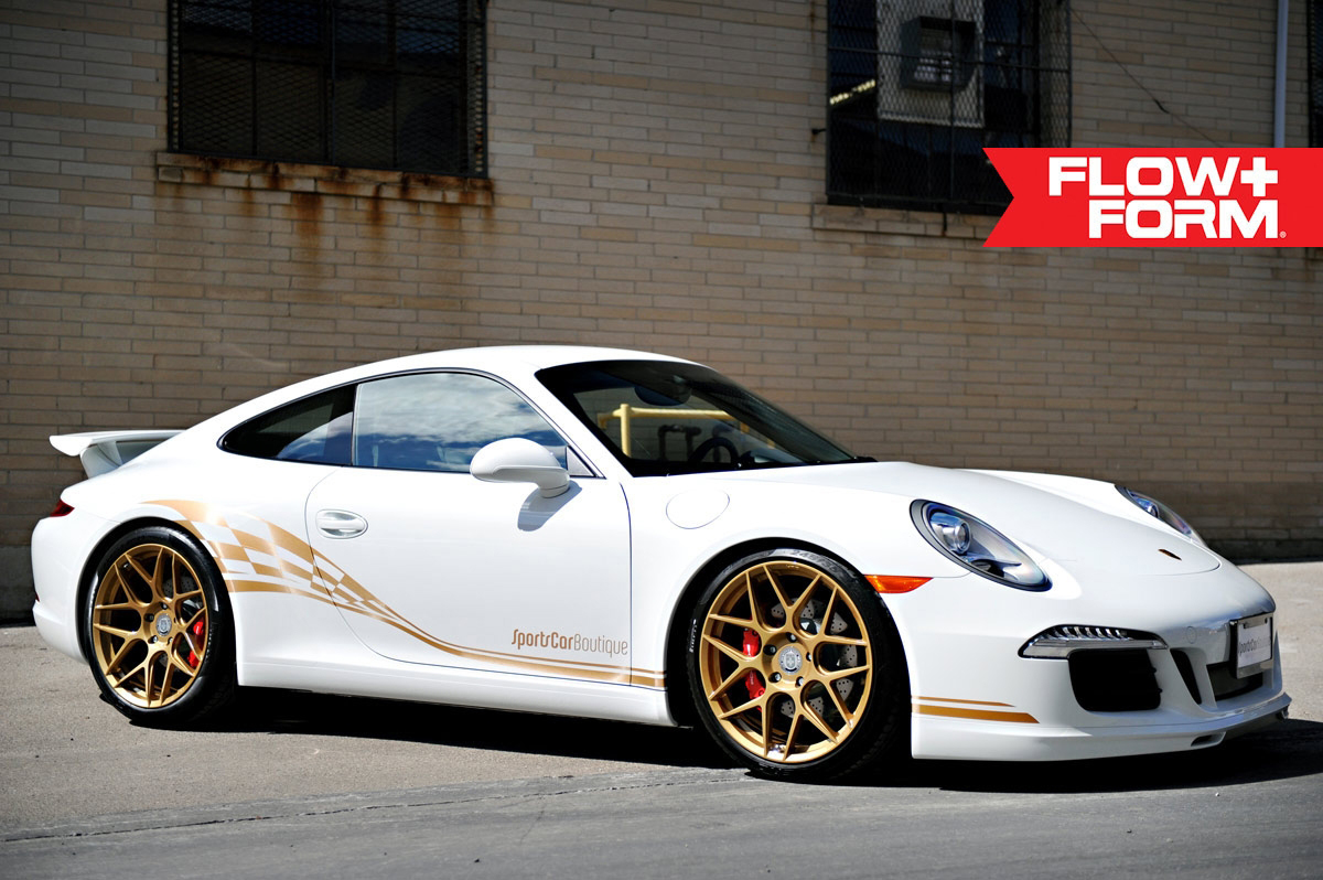

FYI - here at the specs we currently have available for the HRE FF01 FlowForm design you are inquiring about:
19" FlowForm fitment for the 991 (Narrow Body) is as follows:
19x8.5F (22.4 lbs.) ET50
19x11R (24.8 lbs.) ET60
20" FlowForm fitment for the 991 (Narrow Body) is as follows:
20x8.5F (24 lbs.) ET50
20x11R (24.8 lbs.) ET60
The 991 below is running the 20" setup without spacers.
