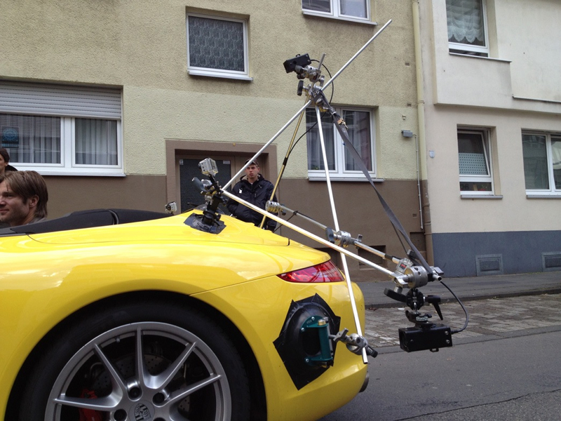

Yes here is the latest factory retrofit. Not too complicated at all

Lol, sharp looking
