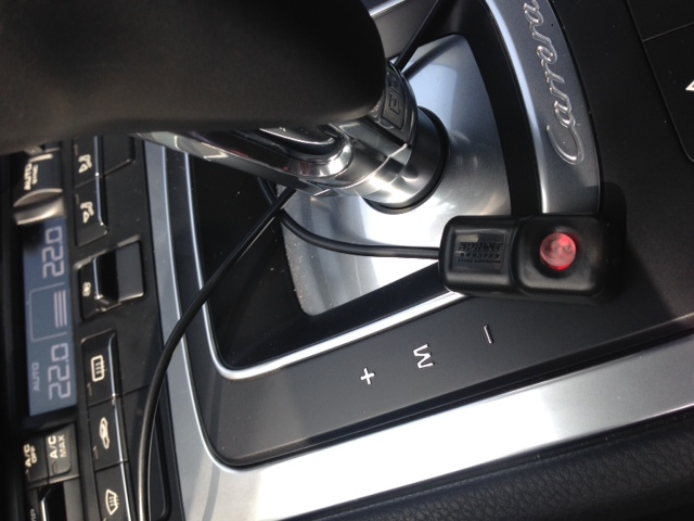

I set my SB in red mode and took the cable off, this is the best setting for this car.
When driving in standard mode the car response is immediate but not aggressive, this is the way the 991 should come standard, I always felt it was a dog on Standard mode.
On Sport mode the pedal feels like driving in Sport Plus but sharper, without the annoying redline gear holding which I find it to be overkill around town, feels fantastic on this mode.

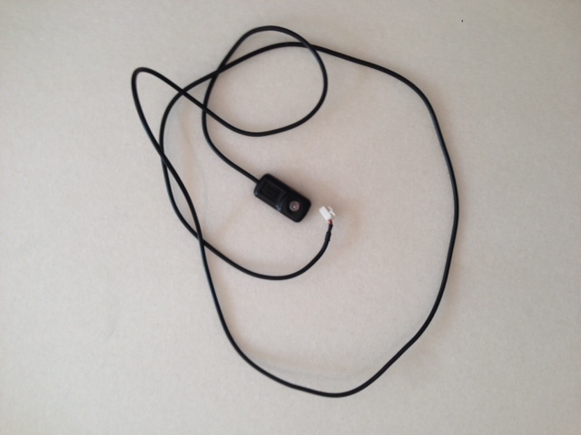

Fester, Bought it from GMP Performance for $275, I think they are sponsors in this forum, it shows 997 but it will fit the 991 as well.
I went to my dealer today to pick up my car with the Sprintbooster at hand, asked my advisor about any warranty issues and he said a straight NO, in all honesty he didnt have a clue what the SB was, I had to explain how this works and he said that as long as I dont touch the ECM we were Ok. He even offered to help with the installation.
I followed the instructions on this thread:
https://www.6speedonline.com/forums/...ns-w-pics.html
Same steps for the 991. Took me 10 minutes at the most.
The only difference is that my SB is the newer version, it has a cable to select your desired mode, then you can take the cable off as it keeps your last setting.
Red is the best setting, it goes from sharp in std mode to ultra agressive in Sport Plus.
