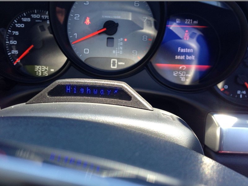

Has anyone figured out how to add a functional button to the center console? It can be done, as noted in this beautiful radar install -- see at around 1:30

That my friend, is a very nice install that looks like the factory did it! Kudos to the installers!

This project has been on the backburner for a while, the original intent was to use the blank buttons to control things like:
Valentine1
Laser Interceptors
Blackvue Dashcam
LED lights
...and to somehow get a custom display for the radar in the dash somewhere. I'm not a fan of the ashtray modules because you really can't see it.
Had messaged a couple of people in the past but don't know how things turned out, if they figured out how to integrate the Can-Bus and install momentary switches.
