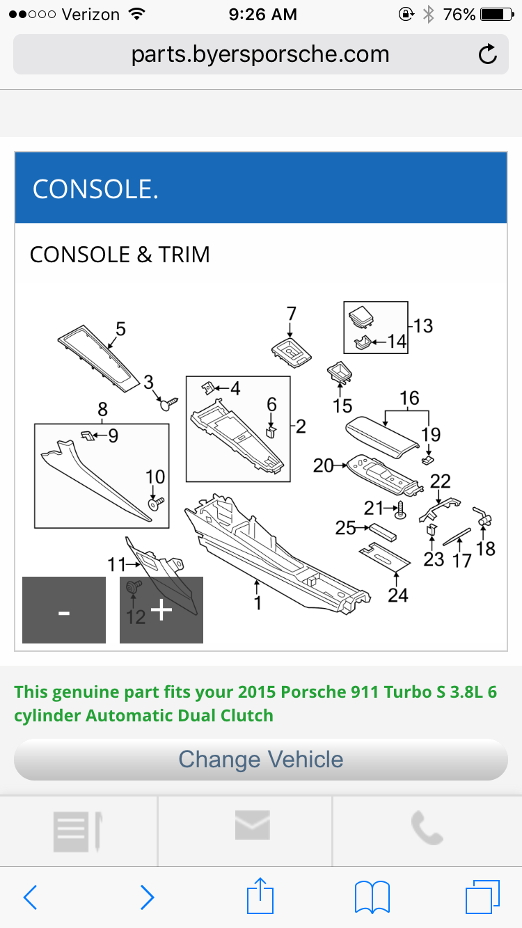

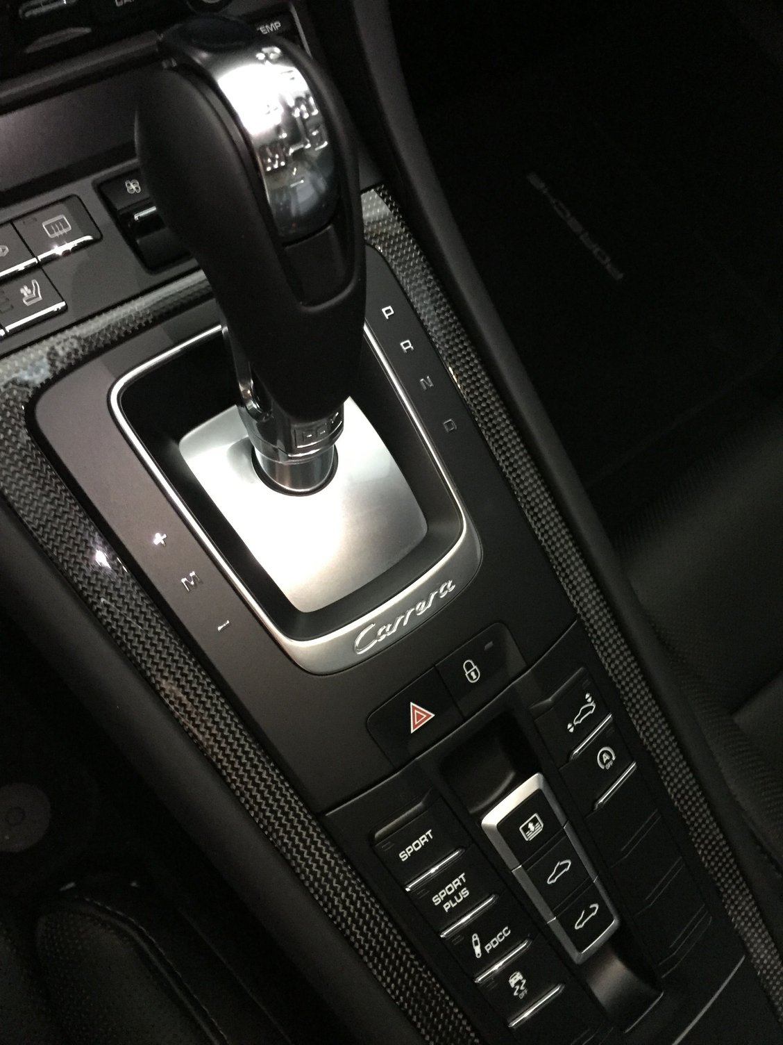

Dumb question - My TTS 15 has a center console trim piece that has "Carerra" imprinted on the center console gear selector trim and for some reason its bugging me. Most TTS have "turbo" on them - was this an option that I missed? Can I change it? I have been searching beyers and sun coast for the appropriate parts but I just can't find them...
If I have wasted 10 seconds of your time I apologies in advance.
I believe its part number 7, the first image with the red interior is what I see on most TTS and the black interior is my TTS... Any help would be appreciated.

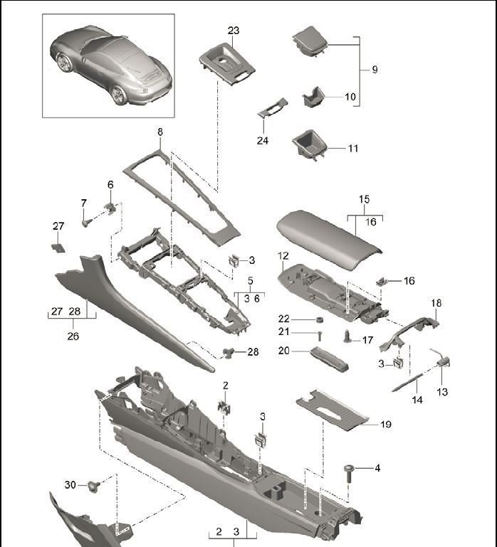

Also, just FYI, the parts image you have doesn't show the entire set of parts for the center console -- maybe there is a reason for that... Perhaps the logo part isn't available separately or something. You can ask your parts source to confirm.
What I've come up with are the following (2) part #'s:
99155324502 Cover PDK DRZ Black/Galvano Silver
99155365101 Cover Logo A05 Black Mat
Here is a more complete diagram:
Based on what you are trying to do, I'd say the part #24 in the above diagram is what you are after.

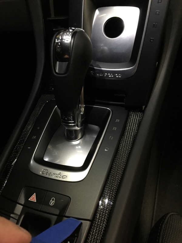

Hey Guys wanted to provide an update - I went down the same path as plenum but could not get one side of the carbon trim pulled up. Rather then cracking the carbon, and feeling defeated I resigned myself to reattaching the portions of the trim I was able to unseat and getting ready to call it a day and drive over to the dealer.
As a last ditch option - I took the panel removal tools from suncoast and pried at the piece in question and it popped right up. Figuring this could be a quick solution, I removed the pdk **** and sure enough the shift gate came right out. I quickly swapped the lock and hazard buttons and pushed it back down. All donzo- plenum thank you so much for the insight and help.
