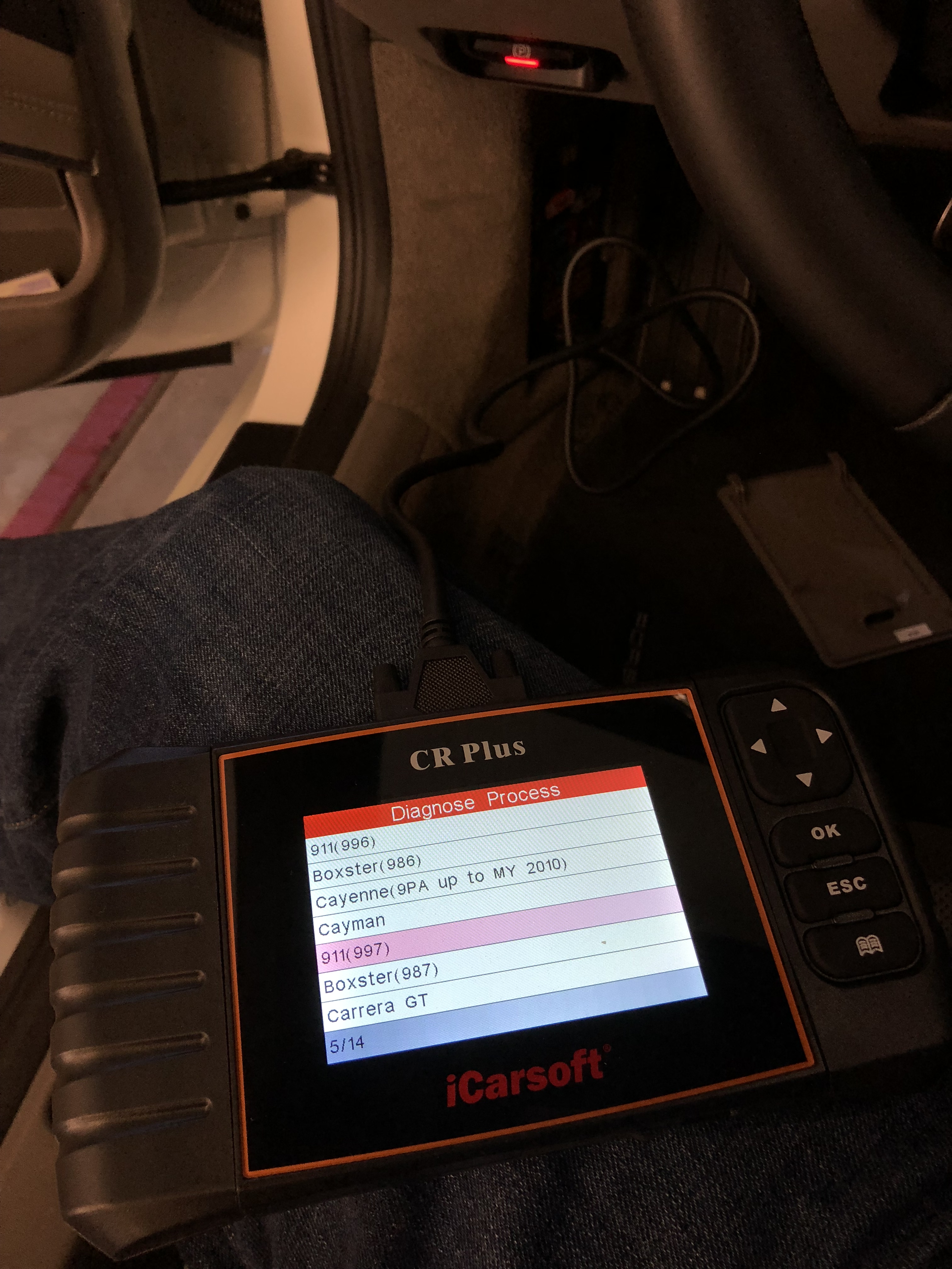

me too, GOT the CR PLUS model, I have other vehicle might also be able to use the device too.
just cleared my service warrant yesterday! wish the "ok" button was in the middle of 4 navigation buttons thou....
