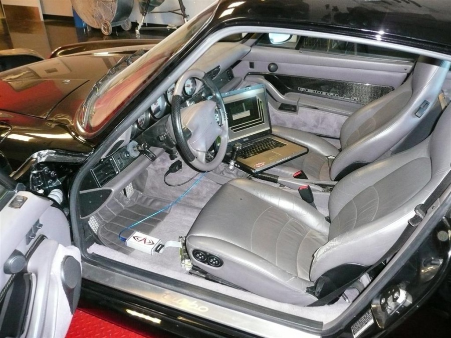

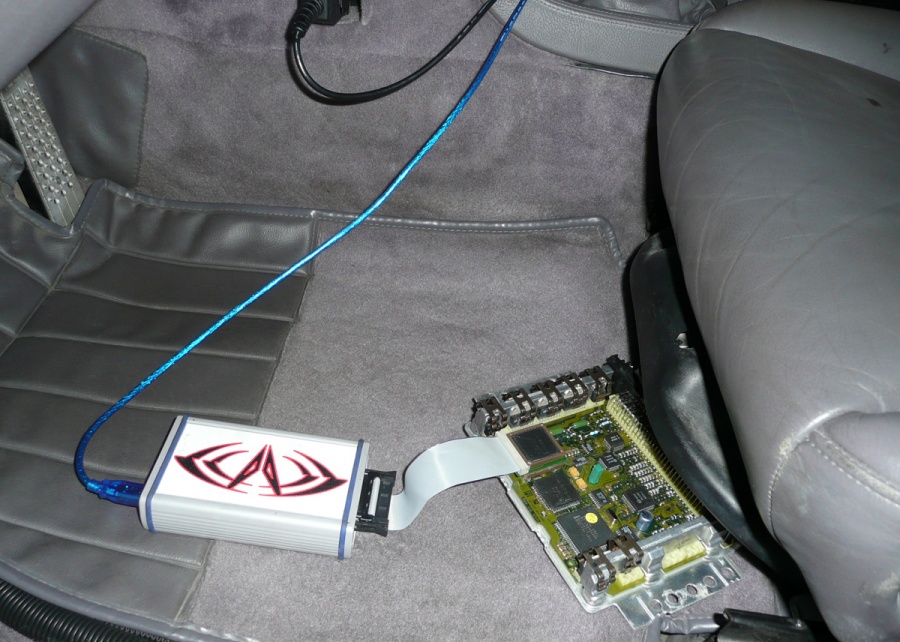

Currently, we are on the dyno tuning the complete package. We are live tuning the ECU with an emulator which makes fine tuning the calibration much more precise. This ECU is an early OTP type which we are able to tune and modify without any problem. I will post more photos and videos of this project later. Enjoy!
