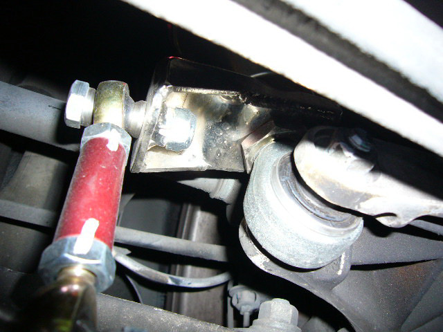

Tarratt DL's on my JIC Cross
Here are the Tarratt's on my car

Correction,
those pics are not my car. They were sent to me to show me the tarrat DL's.
I did install them front and rear and my wheel wells are now superclean unlike the
pics. I do not have mine on the third hole either, Oak. Mine is in the middle.

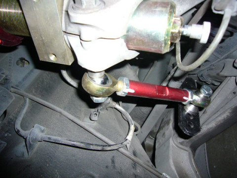

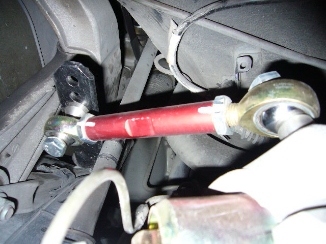

here's what the straight trg dl's looks like. I found that the dl's need to be adjusted with the suspension completely unloaded to get max clearence or the dl's will rub against the axle.

I just installed front TRGs about 3 weeks ago. I had no issue with any rub, and the fronts are actually BENT on the main tube so you arc "around" the axle. Didn't have any pics of this, but you should absolutely NOT rub. My car has been on a roadcourse since the isntal (I did the install myself without issues.) without any issues.
Mine are set on the #2 hole, and I'm using PSS9s, and using the TARRET rear endlinks, also set on #2 hole.

stevo, the ones in the pics are straight dl's. yes I believe there is a curved version, but I don't think they make them anymore. curved is only needed if you use a "tighter" hole on the sway, but in reality the curved version isn't needed as the 996tt has soo much understeer I doubt anyone would even use the last two holes (tight) from the end. I have the fact GT3 hollow sways, set up maybe different for the H&R sways which are solid.
