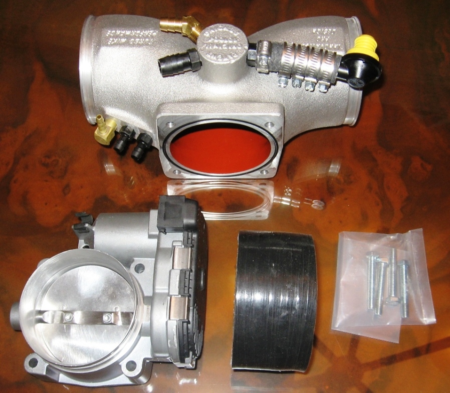

I will be busy this weekend installing this:
The kit is coming with an 80 mm silicone tube to replace the OEM part, thus now you do not need to mod or replace the OEM Y Pipe.
Also, the Plenum looks more than a simple pipe; it is very well made as well as the bored TB.
Finally, great service and support from RSS, thanks Greg and Mike.
I will post impressions soon..

I was under the impression that the OEM Y pipe was part of the restriction and replacing it was the reason for part of the gains.....am I wrong?

After the OEM IC's (I currently have the EVO IC’s) the TB is the restriction at 500 WHP to up. The Plenum plays here a role of getting this extra air optimizing/accelerating the flow at all rpms. Then at 600 WHP to up the Y-pipe start to be restriction.
Furthermore, the OEM inlet turbos pipes are on the other part of the equation the other part that restricts the flow. Those pipes are good until 450 WHP and I may plan to change that as well ..but is a pain to do it and I have to lower the engine.
I think flow is the key and starting from the IC's was a good idea.
