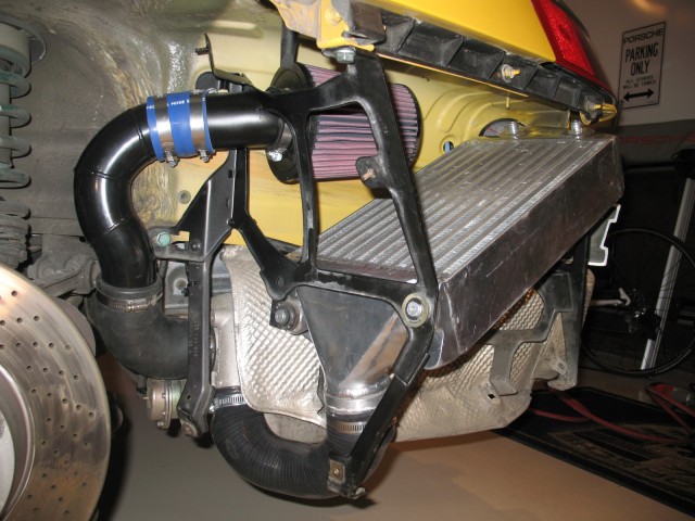

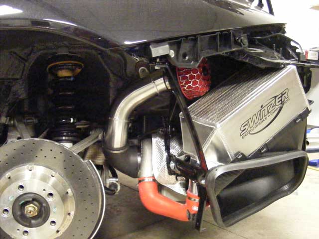

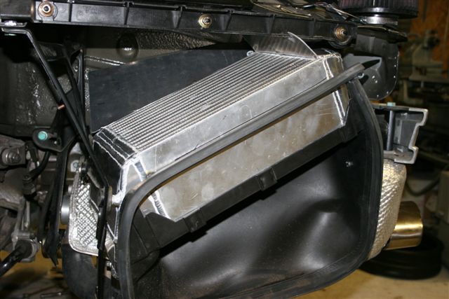

Some different I/C applications:

larger IC's
Is there anyway to retain all the ducting with the larger IC's.

You can retain the ducting with the Blown 6. I think you can with the EVO, as well. I don't see how you could with the larger units, though...unless you did some cutting and fab work to the duct pieces...
