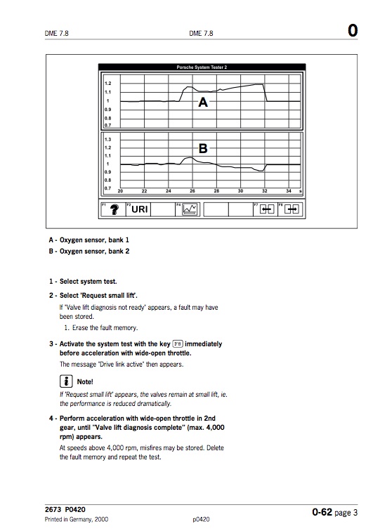

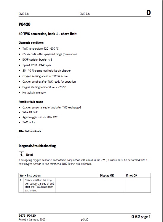

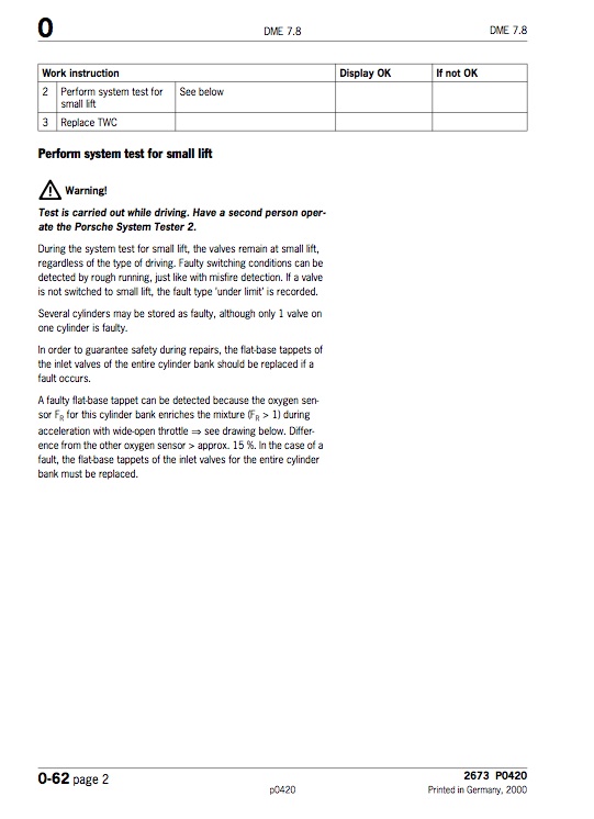

here is the info i found

Thanks for the info Colorinc!
Looks like a need a dataloger to eval the code. I get it very intermittantly after installing sport exhaust with 200 cell cats. I have cleared it twice but it continues to come on every week or so. I suspect if O2 sensors reversed the code would be constant? Maybe an O2 sensor is getting weak (aged)? I doubt its the valve lift problem since it is temporally related to the sport exhaust installation...
