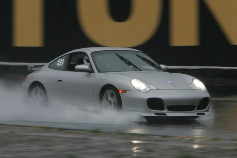

First use of Moton Motorsport Tripples on track.
And, it was a *very* wet weekend, to start with. Sears Point was so flooded the first day, that it was shut down after only 30 minutes of driving per run group. In addition to the water coming down the hill, up the hill, and the mud floating across the top, visibility was getting very poor... and the track is surrounded by walls. Probably a good decision to shut down. At least the 2nd day, after the track dried out, I got to really try the suspension! Sure enough, every click of each of the 12 adjusters makes quite a bit of difference, even with 17 rebound clicks, 15 high speed compression clicks, and 6 low speed compression clicks.
Getting the parts onto the car was quite a task. As some know, I found a set used - supposedly recently rebuilt and ready to install. It turns out they were leaking, broken, missing a number of required components, and as a motorsport part, built so short that there was insufficient droop for use on roads around here. After a lot of consultation with Jerome and Lex, a lot of new parts from Holland ordered, and a lot of labor put in by TC Design, they were finally almost ready to install.
I'd like to thank the people and vendors who helped pull the effort together, especially Dan at Vivid Racing for getting parts to me at the very last minute, so that I could keep the installation on schedule.
It's going to be a lot of fun setting this suspension up for the next Time Trial season!
