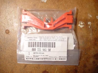

What tool? Link doesn't work? The new 997 shifter came with an "alignment tool" which is a green plastic piece that keeps the shifter in the center position so the cables are aligned perfectly making the install a snap.
Link works fine, but I think you have to be a paying member to access it. Anyway, here's the pic of the tool I'm referring to. Is this the same tool included w/ your shifter?

Posts: 6,453
From: CT
Rep Power: 439
Yes, mine came with a green one.

Maybe the B&M doesn't/didn't come with an alignment tool like the 997 shifter? When I installed my 997 shifter the other day, I bolted the housing in (which hold the handle in place with a plastic "tool" (shown earlier in this thread), and the cables fall right into place as they are sprung front to rear and fall into a cetain position, all you have to do is hold them down and release the sring clips. Thankfully the new 997 shifter is "dummy proof", you really can't screw it up. Maybe whoever did my B&M, didn't do it right?
