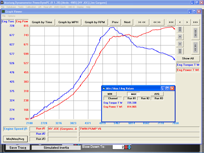

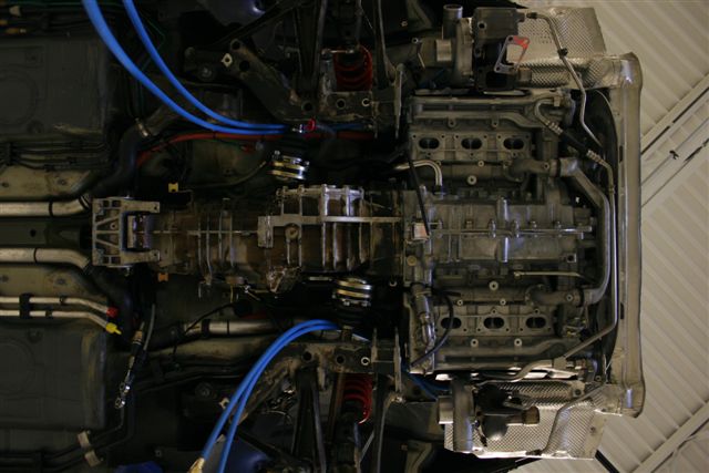

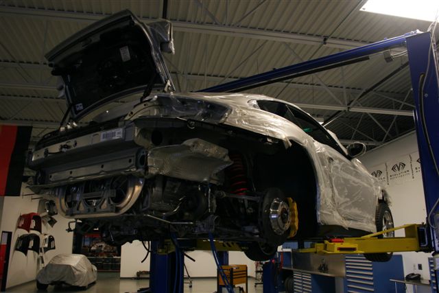

Just wanted to share with everyone what Evoms has done with my 996 turbo.The project is nearing the end of its development stages(I think)and getting ready to be tested at a East Coast track come spring.
Here is what we have done so far..........

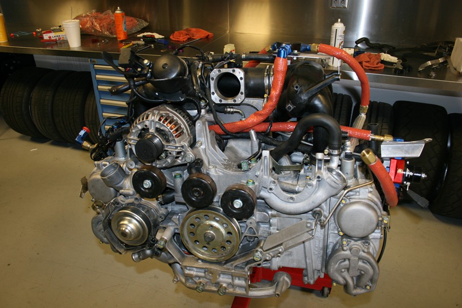

Engine Build=3.8L motor build utilizing GT3 heads and valves(heads were machined for 996tt cam towers and the motor still incorporates variocam.Heads are o-ringed).Carillo rods,CP pistons,GT3 pump,still on stock cams(not for long though),Evoms head gaskets.ARP studs
Turbos=GT35R with Tial 44mm waste gates(Swain coated turbines)
Intercoolers=Evoms,Evoms boost hoses
Fuel system=twin intank pumps,twin intank pickups,billet intank brackets for stock appearing pump mount,-10 braided fire jacketed supply fuel line,-8 braided fire jacketed return fuel line,Evoms billet fuel rails,83lb injectors,Aeromotive fuel pressure regulator,Aeromotive filters
Boost Controller=HKS EVC
Tuning=(EVOMS-it)Tuned by Todd Zuccone
Maf=Hitatchi
Intake=V-flow,custom y-pipe,RSS intake,75mmTB
Drivetrain=Guard billet diff,Evoms axles,Evoms clutch,LWFW
Wheels and Tires=Bogart 17 custom made rims,Mickey Thompson E.T. streets
BRAKES=pccb
Interior=Tequipment bar,Shroth harnesses,GT3 seats,Full interior with carpet and stereo
Note****all dynos were done in AWD on a Mustang dyno to compare to my previous setup(GT800)****
**** It will be track tested in RWD****
