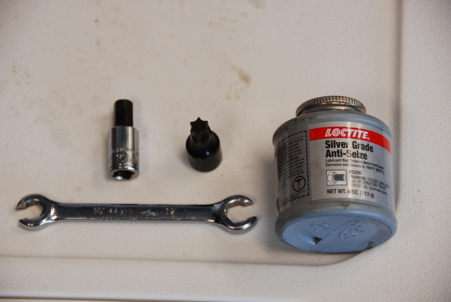

here's what i needed
I upgraded to the UMW brakes (which are incredible on the track) and needed:
A 10mm Hex key (old caliper bolts)
A T55 Torx bit (new caliper bolts)
A flare end wrench 10mm
Anti Seize compound
