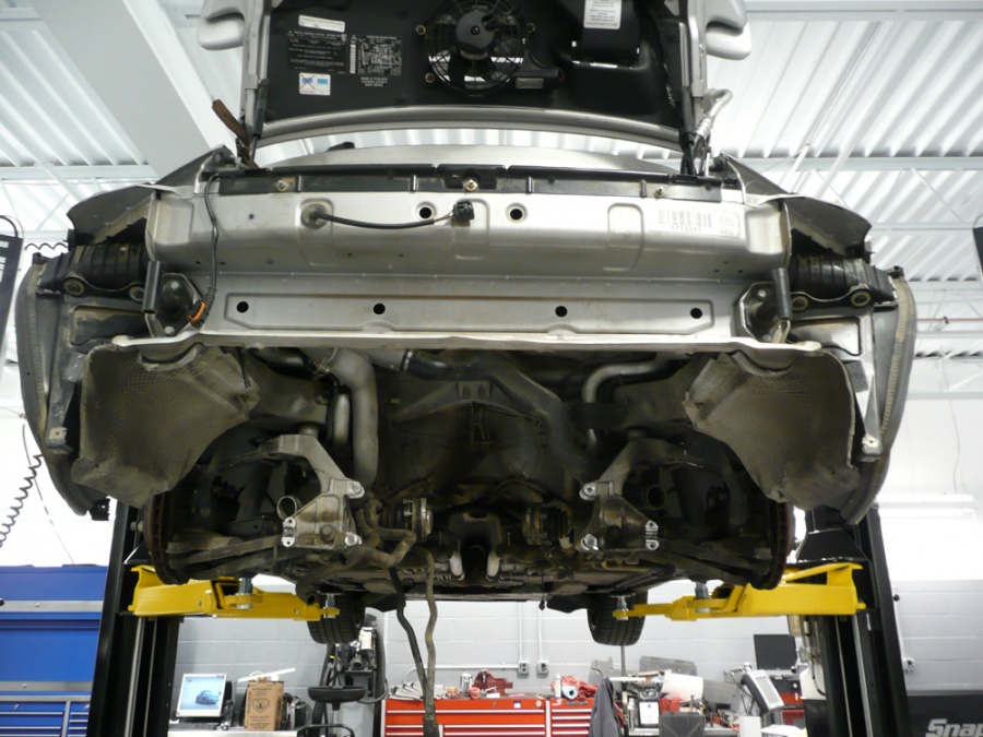

Here is an overdue summary of the recent engine rebuild that was done to my car. Thanks to all of you that gave me ideas/tips to deal with PCNA and the dealer to get this covered under warranty!
ISSUE
I started to notice high oil consumption (~400-500 per quart). I took it to the dealer and started oil consumption test which basically meant bring it back to dealer for them to add oil and track mileage/consumption. After 3 months of test dealer ran leakdown test and compression test but all figures looked fine so he submitted claim to PCNA for engine teardown for further diagnose. PCNA denied claim and asked for an additional 3 months of testing! Dealer agreed this was unreasonable but asked me to do ONE more month of testing. They put new oil, new sparkplugs and after I did that and went back to dealer. Consumption was still high and he convinced PCNA to authorize teardown.
DIAGNOSE
They found some minor scoring on the cam housing (see pic 1) but didnt think this was the main issue. Their main conclusion is that since my car is an early 01 build, it has the "old style pistons" which have no relief holds. They showed me thath the pistons only had one pair of little holes and that the new ones have 2 pairs of little holes (relief holes). Dealer indicated Porsche changed the piston style sometime in 01 and therefore this change would fix my car. My sense is that they werent 100% sure but PCNA accepted the diagnose they proceeded to rebuild the engine with new camshafts, cylinders, cylinder heads (from what I understand this is a top end rebuild).
COST/PARTS
Since repair was CPO I dont have an official invoice but dealer gave me some of the prices for the parts "6 cylinder with PI 996-103-915-74 = $4649, "2 AS cylinder head" 996-104-001-76 = $6890, Camshaft $808, etc, etc....for a total of ~$13000 in parts. AND 6k in labor (3k to open/diagnose and 3k to put back together) for a grand total of ~$19,000.
CURRENT STATUS
Car is running fine (but it was also running fine before!) In the first 500 miles of conservative driving I have consumed 1/2qt which is still a lot but according to dealer it is normal to still see higher consumption during first 2000 miles of break-in period. Their suggested break-in was "first 500 miles at under 5k rpm and vary RPM as much as possible" They also asked me to bring car back next week so they can check for any leaks and other minor adjustments.
CONCLUSION
While painful to go through the process, overall, I am satisfied wth PCNA response. Yes, I wish they had put new engine instead but as everyone that has dealt with PCNA knows, you can demand they fix the problem but hard to tell them how to do it. I think other car manufacturers may have just moved me to a thicker oil and call it a day so all in all I am pleased and, fingers crossed, the car is fixed. I welcome any comments and question (please just dont tell me I should have fought for a new engine...I did and all I got was a $19k rebuild....)
