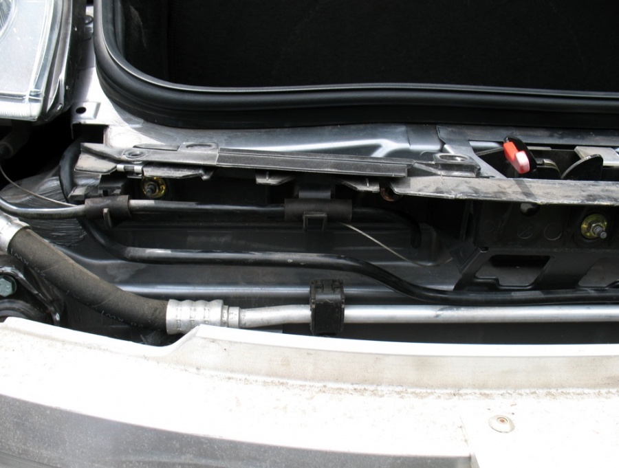

The steel braided wire...not string.....is sitting behind your passenger side headlight. If you open your toolkit and take out the tool that releases your headlight latch (you have to unscrew that black plastic screw on the interior liner and pry your liner away from the side)...then insert the tool in the slot on the side of the headlight and rotate it about 180 degrees...your headlight will slide forward and come all the way out..and you can see the wire lying there. Many folks re-route that wire so that it can be accessed by reaching up inside the front grill (hide the wire so it cant' be seen) without having to open your trunk.
I don't recall if the procedure is covered in your owner's manual. Once you've seen it done, it's simple. Takes about 3 minutes to take out your headlight module.

the cable...
With the front plastic bumper cover removed you can see the cable...
