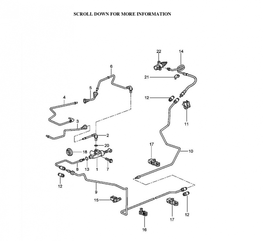

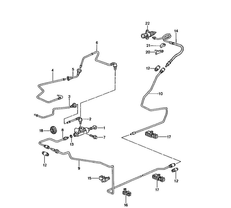

  #37
jpflip's Avatar
Joined: Mar 2008
Posts: 2,807
From: Montreal Canada
Rep Power: 268
jpflip Is a GOD !jpflip Is a GOD !jpflip Is a GOD !jpflip Is a GOD !jpflip Is a GOD !jpflip Is a GOD !jpflip Is a GOD !jpflip Is a GOD !jpflip Is a GOD !jpflip Is a GOD !jpflip Is a GOD !
amazing similarity...
On the left you got the 997 and on the right the GT2 2003-2005.... No comments..... Anyway somebody somewhere took a good decision and kept the good working system and we are stuck with the bad one ;-(
Sorry about this mistake but the one on the left is for the GT-3 and the 997 non turbo....Cannot found the turbo parts cat...
