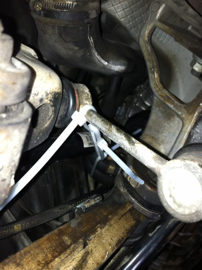

Here is how I tie wrapped my coolant lines which provided great access to the CA.

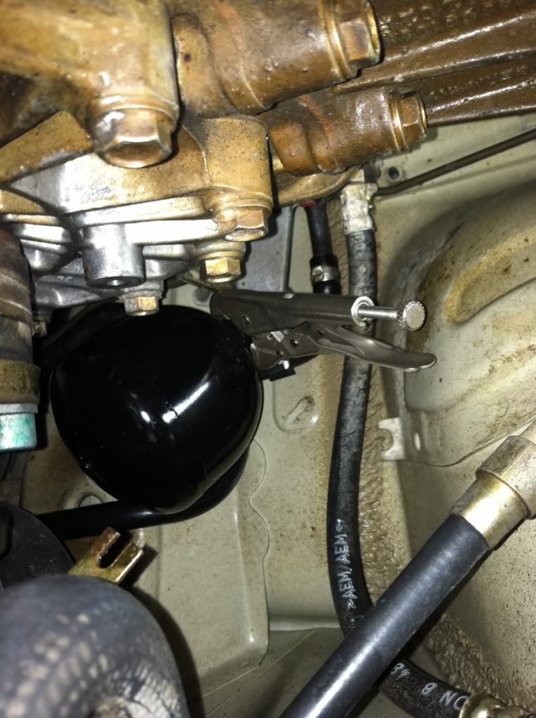

Tightening the CA was still a PITA, I used my hands with rubber gloves (be sure the CA is cleaned, I used brake cleaner on the outside). I couldn't get my 27mm wrench in there and the filter strap didn't seem to do much so I squeezed in a small pair of vice grips (I pre-set the grip to the fitting before I installed).

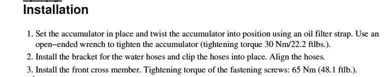

What is the approximate torque spec on the accumulator?

22.2 ftlb....Repair manual page 677.

No way you're getting a torque wrench on that thing. I went about 1/16th of a turn past hand tight. I loosened it again just to test how tight it was and it took about the same amount of force to loosen as the original did.
