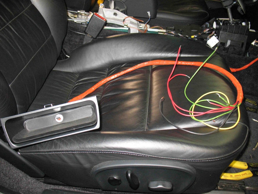

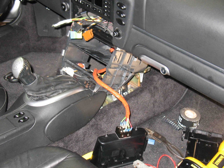

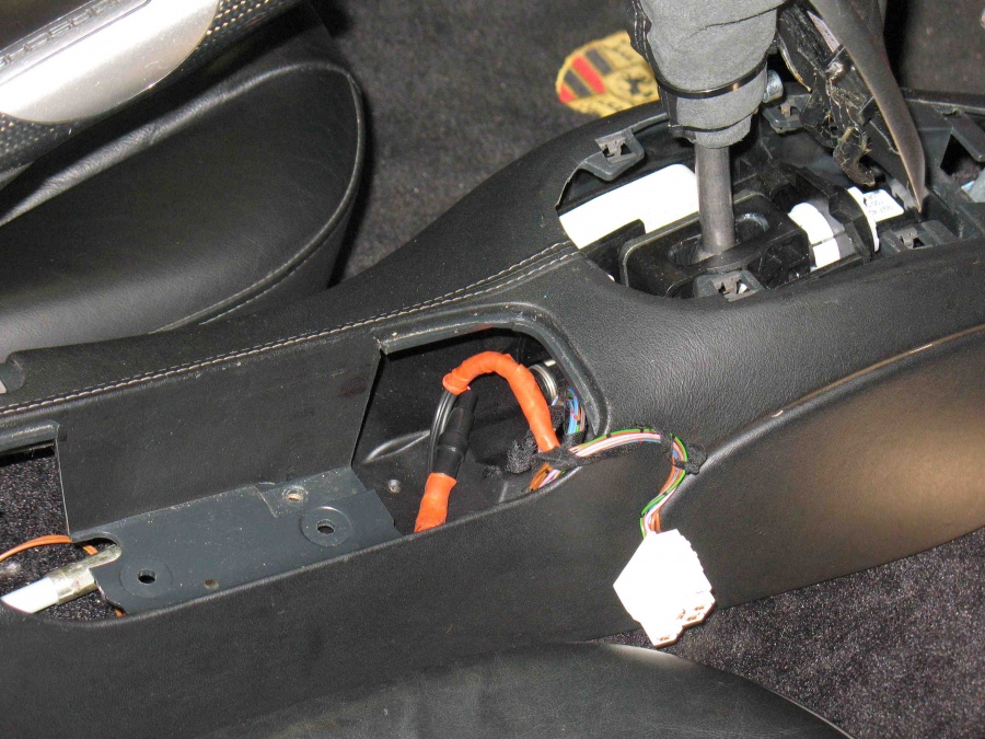

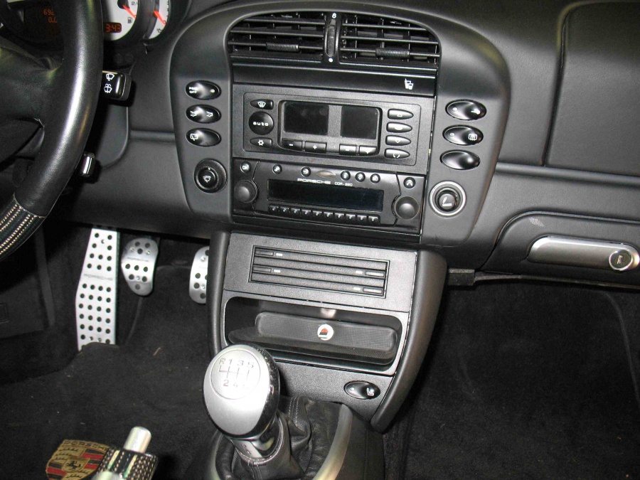

Just completed the installation of the iPorsche kit from Cody. The only modification I had to do is the installation of a switch to keep the CD changer in working condition. So now with that switch, located in the bottom of the lower compartment of the console, I can select either the ipod or the CD changer. Of course the car is now heavier because of the extra wires and that big switch The Ipod connection is in the armrest and the fuse under the hashtray....Thanks Cody for the great kit and the instruction.

I like it, it's simple and looks like it's pretty seamless.
One thing i would have suggested while you were down there...how come you didn't just install a carputer setup?
You'd have a nice screen there any everything..

I got the same kit and have been very satisfied with it, keep in mind it only works with the 12V charging ipods not the newer 5 volt. This means you shouldn't run out and get the newest ipod because it wont work. This kit has been great for me but I opted to put it in the console below the A/C so I can change the ipod on the fly. (something you may want to consider)
