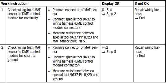

Could also be the wiring from the MAF to the DME.

Update
Okay gents. (I wanted to give this running account to help others who my have the same problem; I noticed in searching older threads that no one updated their posts when a problem was solved.)
I disconnected the battery, cleared the P0102 code and THE ENGINE SHUTS DOWN.
On my way to the dealer this morning, the CEL appears and stalls. I am in the middle of Crenshaw, one of the busiest streets in my City at that time in the morning. I crank it up; it stalls 3 to 4 times; and we can only limp to the dealer at no more than 40 mph.
I just got a call. Dealer claims it is the throttle body. I ask why the problem was not detected when I brought it for the major service, when they replaced the MAF. She said it was because of a false code. WTF. She said the good news is that the throttle body is covered by my warranty.
I hope all of the gremlins are gone. the car will be ready tomorrow.
