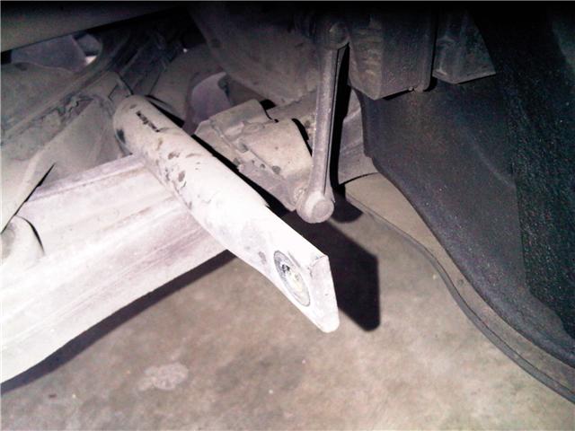

heres the pictures of the swaybar and pss9s
is this the stock 996 turbo swaybar? no matter how i do it, i cant seem to get em on
Old Jun 23, 2009 | 12:09 PM
vividracing's Avatar
Posts: 17,404
From: Gilbert, AZ
That is the stock sway bar. Where is your sway bar link?

You need to attach the sway bar LINK. Post a pic of the links you got.

My stock links were about 11.5"
My Bilstein links are about 8.5" eye to eye.
I like Dan's Pinch Bolt Mounts. Pretty cool.
