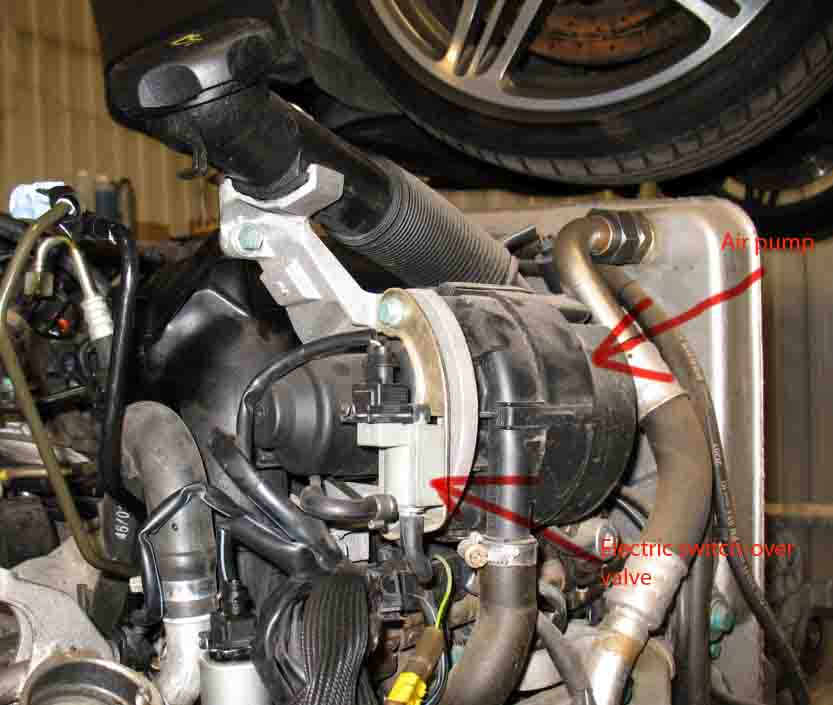

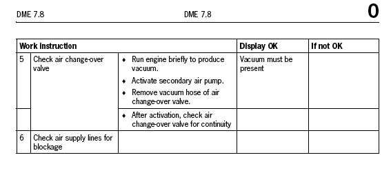

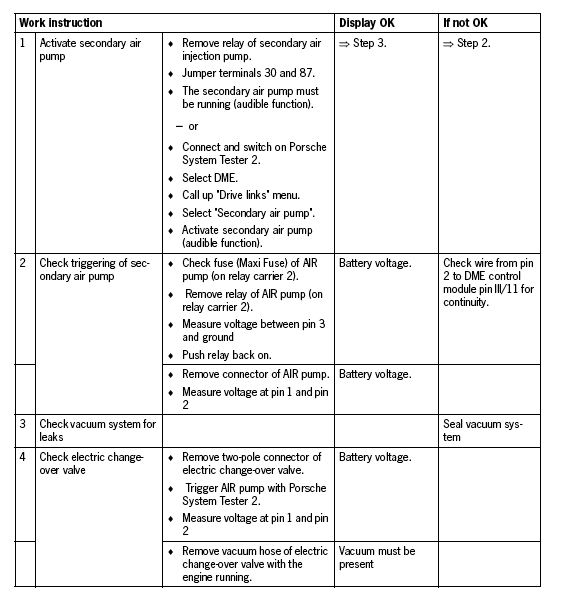

It is related to your secondary air pump, it has no flow. First thing to do, if you have a Durametric, is to go to "drive link" and select "secondary air pump" if it is not starting , check the fuse. It is located on relay panel #2 besides the ECU. Over the rear seats. If you don't have a Durametric simply start the car and locate the pump on the right side and see if it is functioning. It should start for a period of 50 to 179 seconds. If the fuse is Ok there is a possibility the pump or the relay is unserviceable. The relay can be check see the pics.... But the sad part, the pump is really expensive, part# 99660510400 $1472.25....Go through all the steps of the "work instructions" before you purchase a pump.... Also I add a picture of the pump and the switch over valve. This valve can also be at fault and all the vacuum lines going to it should be check properly... Good luck...

As stated above..
P0491/2 Secondary Air Injection System, Bank 1/2 – Below Limit
Possible fault cause
♦ Secondary air injection pump is not triggered
♦ Secondary air injection pump does not work
♦ Air supply lines restricted
♦ Electric change-over valve does not function
♦ Air change-over valve does not function
♦ Vacuum system leaking
I would seriously look for leaks. How is the car running?
