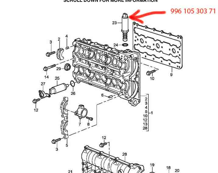

P1349 can be check easily with Durametric. Go to "Drive link" and with the engine running at idle select "camshaft adjustment bank one" and after select start. The engine should be running rough or rumbling. If it does that mean the solenoid is working good and the system also is working good. For your misfire, you can also eliminate the fuel injection possibility by selecting one after the other the injection valve and select start after the engine should also be rumbling... Note: After a test don't forget to select stop before you start a new test.

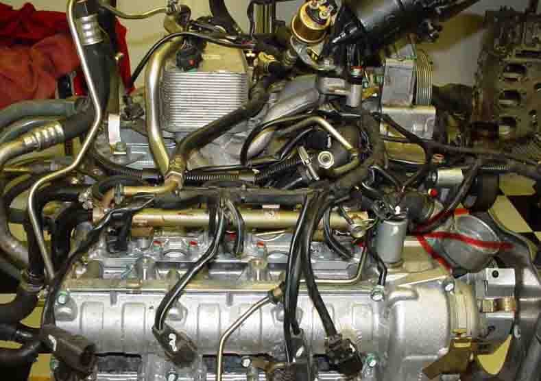

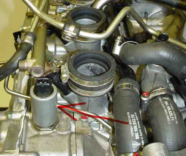

P1349 is normally related to a solenoid 996 105 303 71 ($190.75). It can be replaced with the engine in place. (see pics) (but not an easy task....)
Misfiring can be so many things but of course plugs is the easiest to do first as mention previously ....
