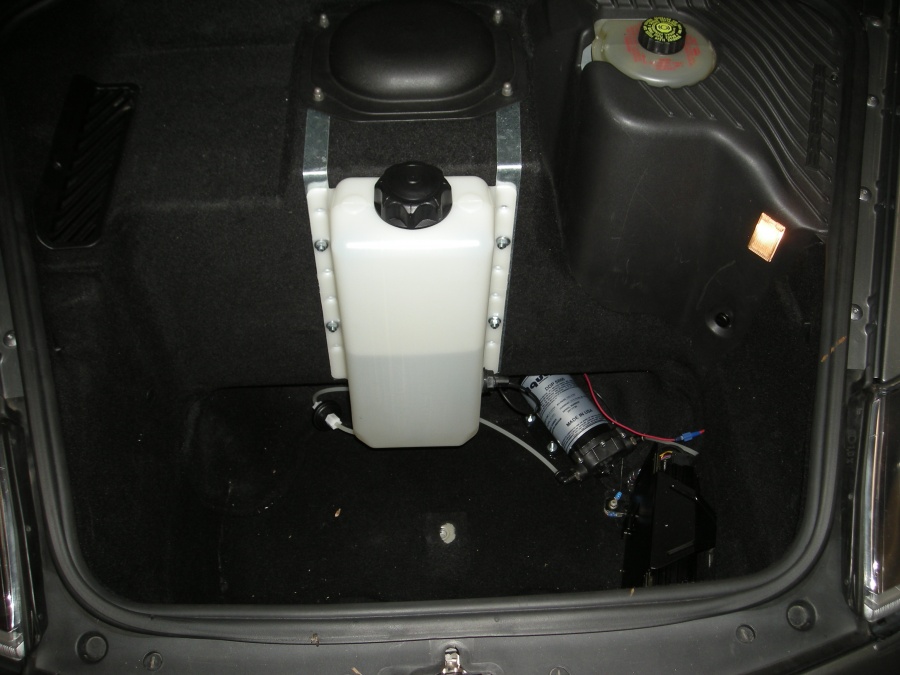

I believe I have .9's spraying 50/50+100%. Don't think you can use factory coolant resevoir as the float switch won't fit anywhere, unless you want to forfeit that safety element. Wouldn't advise it. Just buy a 1-1/2 gallon bottle.
Thanks for the info. Couln't you just use the existing float level switch 9I assume this is what you are referring to) in the stock reservoir? It already has one. Just put a tap into the bottom of the stock reservoir and feed the pump from there.
Just a thought. I am still deciding. Where does the external tak go?

Easier for me to add the tank.

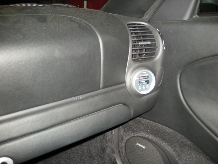

I see. I will not be using that system though. I am going to go with the 2D Mapped system. I personally do not like the gauge in the car (my personal choice here) I will also be using the race pump. Personally I like the car to look as stock as possible. Nice system though.
I will be using the system for Intake Cooling only and not as a performance enhancement. I had a lot of success with this particular system on a few Lotus V8's and I installed this system on a few of them, in addition a Lotus Garage in SoCAL uses my design on cars that they do too. We did use a separate tank for that application though.
