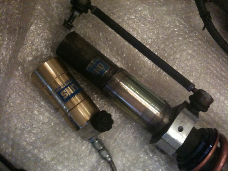

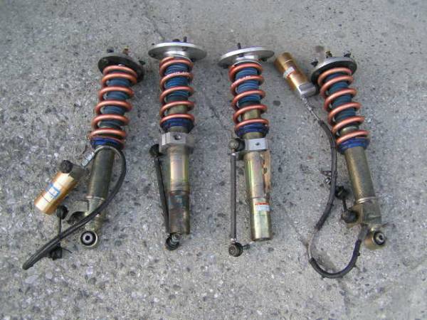

This is the pic I got from him

I don't think those mounts will work on the TT. If his car is 2wd the mounts will likely be different. What kind of car did they come off of?
