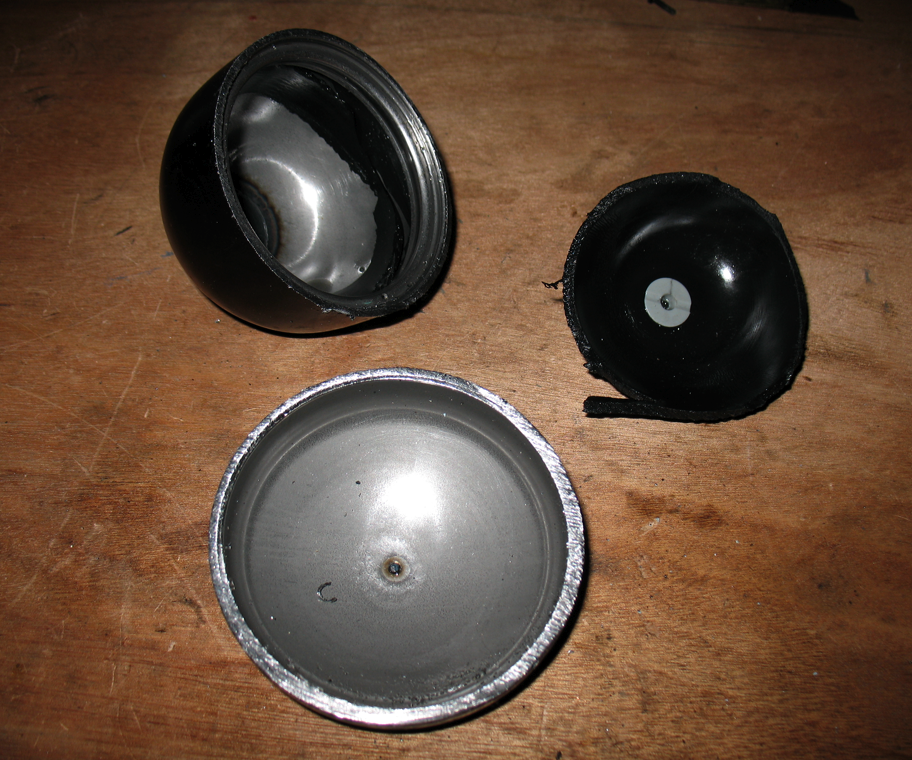

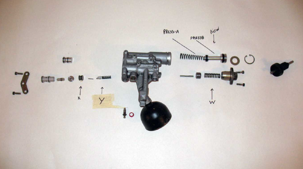

This is from my personal experience and also I completely dismantle the slave to found out the way it work and also dismantle an accumulator....My conclusions are:
Just to summarize from all pentosin threads:
Accumulator unthreads = leak in engine bay? : no, leaks under the center of the car in the transmission area were the accu is located
Accumulator "breaks" (please fill in someone) = Won't get clutch assist at idle.... Or harder to depress...
Rear reservoir leak/overflow = does this happen and how? damaged to power steering pump (whistling noise from the pump) Tsb#4897
Overflow/Greasy Pentosin reservoir at left front = faulty slave valve? yes, slave
Leak coming out from plastic "pan" under front of car? (front pentosin reservoir?)[/QUOTE] same as before???
The slave is only there to take the pressure from the clutch master cylinder (form the clutch pedal) and the pressure from the steering pump to make the clutch pedal less hard to depress....

About "the leak" / puddle - it turned out that my accumulator was dry as a ... match. Nothing there whatsoever looking wet.
However.. and haha it was a good b-day gift once I got to the shop and got the plastic underbody pans off - it turned out that when I put the coilovers on a few days ago, I didn't snap the front halfshafts back all the way in (both sides) so it was a bit front diff oil leaking out from when taking turns, oil ending up in the underpan and making a nice wet puddle. I recognized the ugly smell right away. Snapped the shafts back in fully and just cleaned up all the pans, all nice and dry! Not enough loss imo to need a refill either for a few power runs on the dyno. Diff goes out (forever) on Saturday, can't wait to do this.
However, still have some Pentosin residue around the front reservoir.
