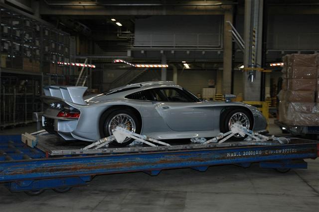

Must be Bob Moore, eh? I think they had theirs on Ebay a couple weeks ago. That's pretty ugly news re: the windshield, and I've been wondering how painful that would be (already have some chips).
