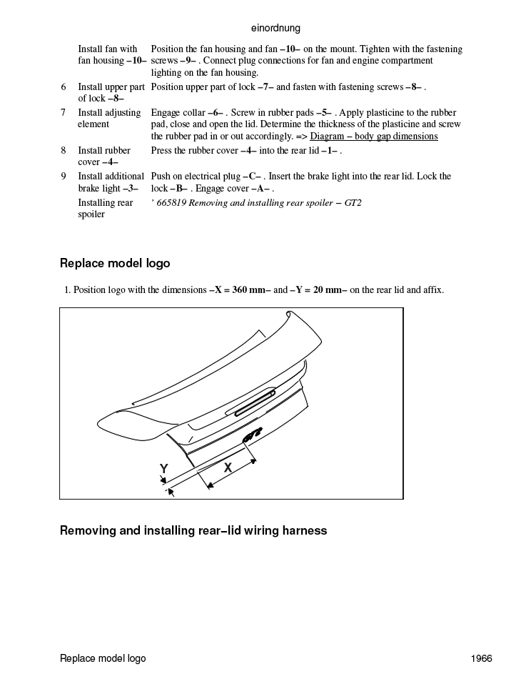

I removed the "GT2" emblem from the rear of my 02 GT2 and now after looking at the car without the badge I decided it needs the badge back on.
What I didn't do was to measure the distance from the lower edge of the lid to the bottom edge of the badge. If someone could throw a tape measure on the lid and let me know the measurement I would appreciate it!!

i will take care of it for you in a few mins

one inch

From the repair manual...
From the repair manual page 1966

I get 23mm

Hard braking move your logo 1 mm higher....

Thanks guys for the quick replies!
I am going to split the difference (22.5 mm) and dig out my digital calipers.

re measured it from the bottom of emblem to the gap in the lid and got 7/8ths.. first time i got one inch measuring by putting tape in the gap and reading to bottom of the emblem... i mean its so close.... what did the book have to say?? .. book says 20mm i guess thats to the bottom.... is 7/8ths about 20mm?? i dont have a caliper sorry
I found it in the repair manual, but of course if the logo was put on a friday afternoon just before quitting time or a monday morning after a night at the bar, it can be off a little bit....
