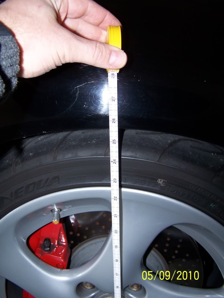

endend up buying pss10 and installed them today. something odd about the front setting i'm confused with. it is at it's lowest setting for height but it sits at about 25 1/2 on the front and i can't go any lower cause the collars are at the very bottom is this because i installed the top strut bearing mount metal plate with rubber bushing and the provided rubber bushing that came with the kit? i have no noise complaints at all. all quiet at full turns or going over bumps. just thought i should be able to lower it more any one know. maybe take out the rubber plate bushing that was provided?

anyone know can someone post a pic of a 996tt with pss10?

Mine is just under 25 5/8 in the front and it is NOT as low as it can go.. Not sure this is what you are looking for...

That's perfect. Exactly what i'm looking for.I think i know what i need to do. Gotta remove the rubber o ring they provide

I think in my case, 25.5 is about max low....
I run 26" all 4 corners to avoid scraping. That height was a good compromise.

The fronts don't allow you to lower as far as the rears. I had the same issue. They do have shorter helper springs which will drop it another 1/4". Beyond that you have to start dealing with shorter (but stiffer) spring sets (both front and back) to lower it further while minimizing riding on the bump stops

Just MO, instead of having the same heights on all four corners, you should bring your car for a good alignment and corner balancing.

+1. I didn't want to confuse the issue and measure at each corner. Agree 100% - you need a good alignment and corner balance - preferably from a shop that has track experience history.

exactly what i'm going to do. i'm just going to let them settle for a bit then i will corner balance and align it at work myself. i did set the toes when i first put them on but will realign at the same time of corner balancing
