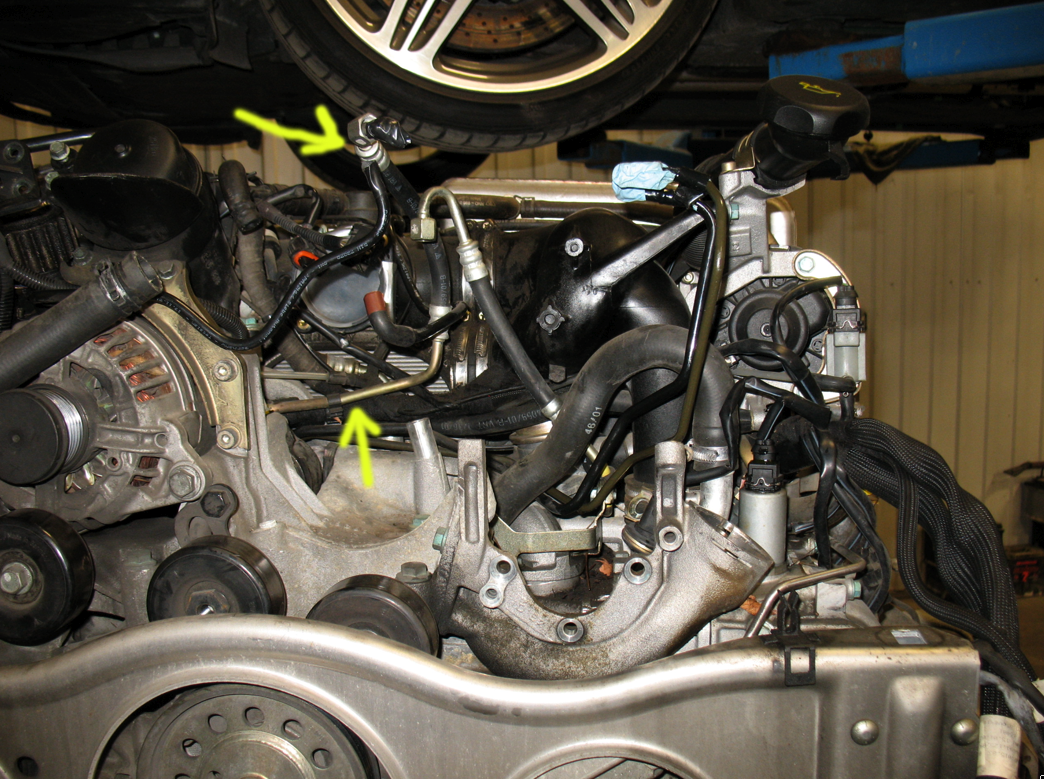

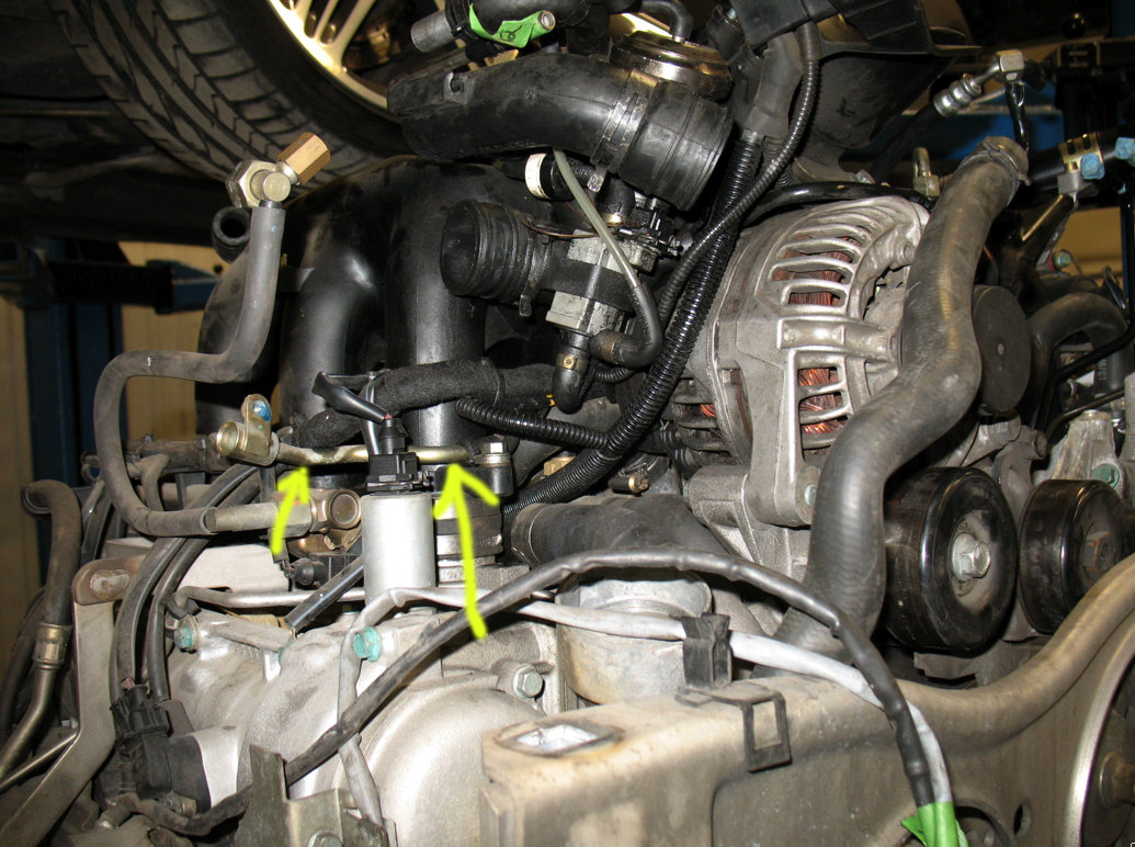

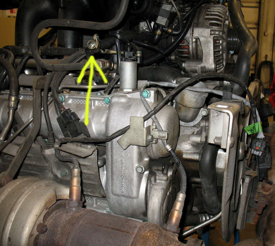

IMHO I think this line replacement doesn't require dropping the engine but instead lowering the engine. This seems to be line # 15 which is not too long and the other end of the fitting looks like located in the engine compartment. Be careful when you order the part because MY01 and the other MY looks different. If you look at the pics you will see the line running behind the alternator under the oil filter. I can see a couple of clamps. Probably not an easy job.... Here you will found the instruction to lower the engine from "rolfjahn" https://www.6speedonline.com/forums/...tt-engine.html

yikes, yea may be possible to do by lowering. but looks like part of the #15 hose is hard piping. Not going to be easy and lots of stuff has to come out. With the right tools, man hours to drop the engine's probably going to be less than lowering to get that stuff out. one way to lower the cost is spread the labor over other maintenance/preventative/mods...
