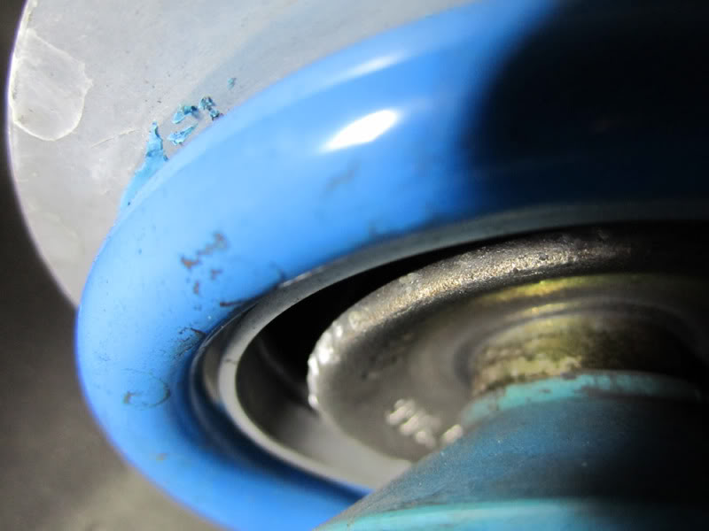

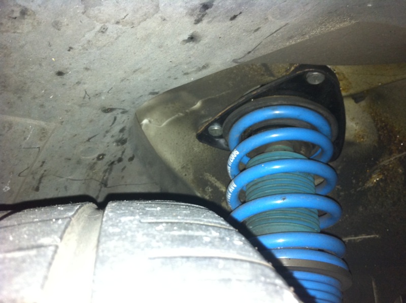

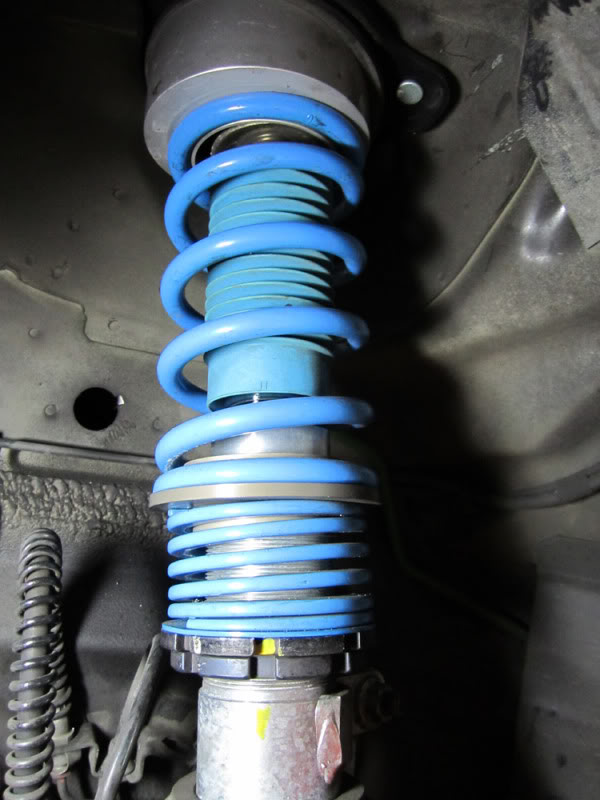

So I lifted the car today and surely enough, the rubber top spring seat was missing.
Here's a picture posted by SMR996 on rennlist:
I'm not too sure if the thrust washer is in or not, but since I'm taking everything apart, I'm going to go ahead and order new ones along with the rubber top spring seat.
I'll post back after I get these parts in.
