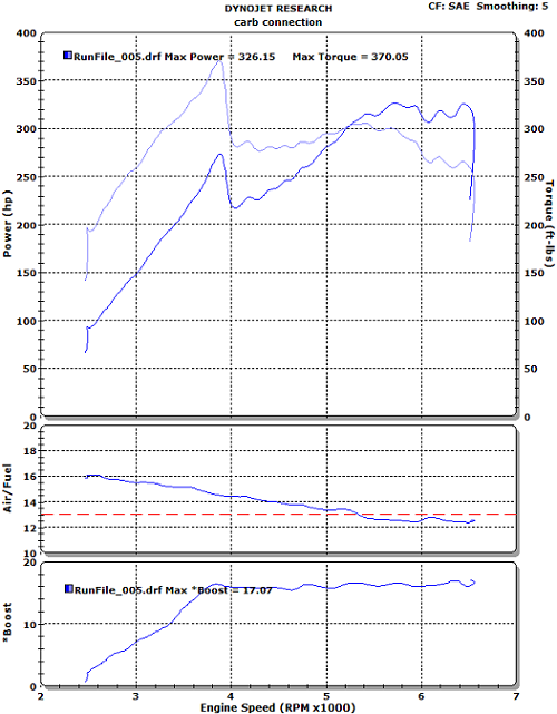

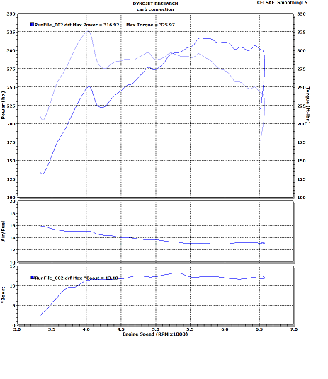

Hey Guys, I'm hoping to tap the wealth of information and knowledge on this forum. I just got my graphs from a dyno run last week and have included them below. The runs were done RWD only on a Dynojet 424. The basic history is the car (01 996tt, 42k mi, Tip) is new to me, appears completely stock, and is throwing overboost codes. Previous owner allegedly hasn't done anything to the car.
In spite of my searching, I haven't had any luck finding graphs showing a/f and boost with the hp/torque curves. I'd love to have a bunch of HP, but not at the expense of lean a/f ratios. It's like the race motor builder saying "fast reliable cheap, pick 2".
My car seems to be sensing the boost and/or detonation and pulling back the timing around 3800.
I've got new DVs in hand, and am probably gonna get a 5 bar FPR. I'm gonna keep the stock exhaust.
Does a flash fix this with the above parts? What am I missing?
edit: run 2 is in 4th and run 5 is in 3rd

13 ish a/f at wot does seem a bit lean. but Im no expert, Im sure others will chime in.
Have you checked the wastegates?

Thats a DEAD LEAN map.. How at Peak TQ is the car surviving at 15:1 AFR?? Its just amazing the abuse the Motor will take.. My guess aside from possibilities of mechanical issues is that the car is Knocking so bad down low at those AFR's it will never recover as it comes finally drop richer at the very end of the pull.. I dont know how the mapping works 100% but most cars drop into a safer map when they see Peak Boost & TQ and are DEAD LEAN.. You need the car looked at before you step on it any more..

17 psi = 1.16 Bar
That has got to be about the limit of a standard Turbo and actuator. I see no attempt by the DME to drop the boost from your graphs. This make me think that:
1. The last owner was a Subaru Owner and has wound the hell out of the Waste Gate control rods thinking it would give more power with more boost.The N75 control valve only has a 75% duty cycle might not be able to control the boost. I would have liked to see some boost control no matter how minimal though. Unless the rods have Maxed out!!
2. The N75 valve is not working and allowing max boost.
3. Both Wast gates have seized, or control pipes missing?
Note on your graphs for run 5 there is no early over boost peak on the graph and the line is level and at max engine revs the boost is still the same. At any other time I wish my boost graph would be so constant. When the Dme pulls timing you can see the power drop but absolutely no boost drop. IMHO unless the DME has been flashed it should have tried to pull back some boost. Unless it cant do so due to a problem.
Just a thought.
