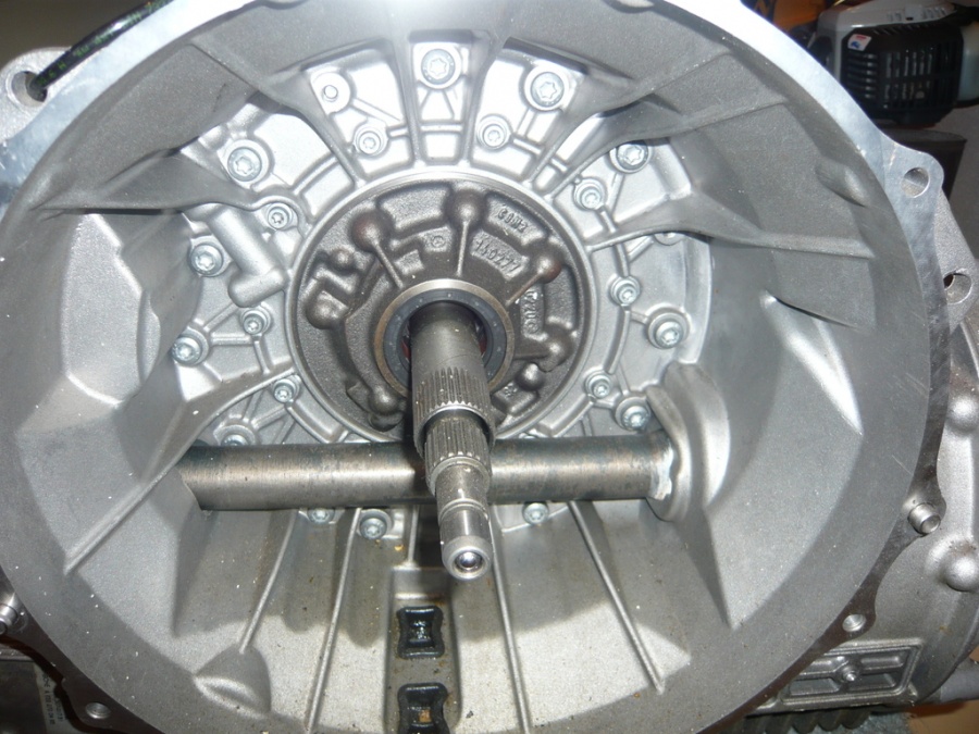

Anyone removed their TIP transmission? I have a leak in the seal forward of the converter and need to get the trans off. The manual only speaks of removal of the entire engine. I wonder if the trans can be removed without taking the engine out? (I hope!!!)

Looks like the seal on the gearbox side of the TC. Inside the bell housing. The sump seal also leaks but that is the simple one.

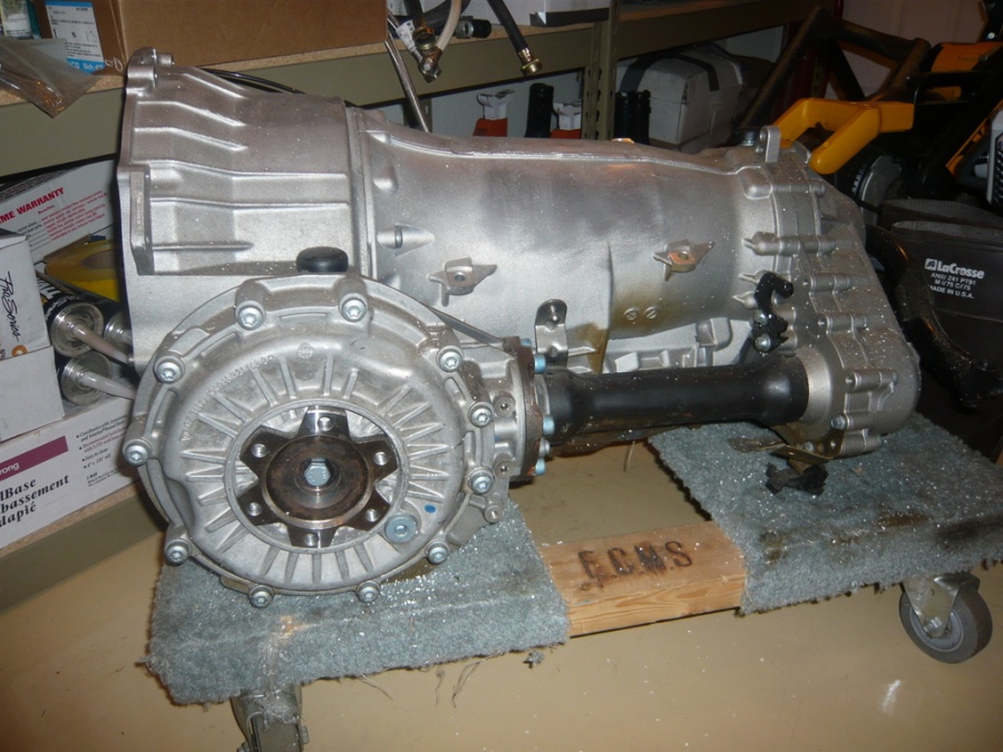

yes because of a seal
http://www.autoatlanta.com/porsche-p...-05/320-01.php
the big one w/o part number!
I put some pics with a gearbox maybe it helps you!

Thanks Alex,
That's just the diagram I was looking for. I'm gonna be tearing into that part of the trans. If I take that cover apart is all the trans fluid gonna come out?
I have excessive play at that front output shaft and probably a bad bearing.
Did you make a new paper gasket or just used silicone?

alex55 Is a GOD !alex55 Is a GOD !alex55 Is a GOD !alex55 Is a GOD !alex55 Is a GOD !alex55 Is a GOD !alex55 Is a GOD !alex55 Is a GOD !alex55 Is a GOD !alex55 Is a GOD !alex55 Is a GOD !
I don't remember if anything (fluid) fold down, maybe a little bit. you can not find the gasket, I use the silicone from the fabricator of the gaskets, a special silicone that can stand at high temperature.
ps. the pics are not from my car

Well I figured I'll check.
Be ready with some buckets. I'd say about 3 quarts/3L came out.
Below is the thread I just made with pics. This is definitely not a beginner DIY so unless you got some thick wrenching under your belt, have a ton of tools and resources and a VIP membership card to Harbor Freight, attempt at your own risk...BTW I just love how logical and easy this car is to work on.
https://www.6speedonline.com/forums/...ml#post2902588
