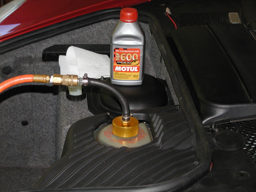

Over the years, I've tried just about everything for brake bleeding, including: someone in the car pumping the pedal, speed bleeder check valves, Motive pressurized bleeder, vacuum pump, ... You name it, I've tried it.

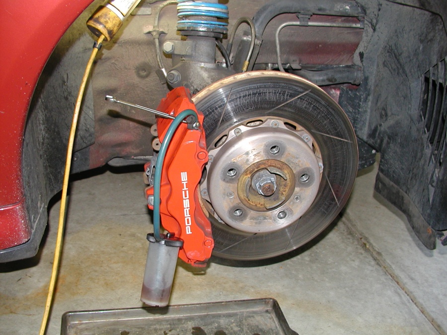

My indie recommended that I try a pressure system, and he loaned me his to give it a try. I have to say that it feels almost like cheating - it's so easy. It's a pressure tight cap that screws onto the brake fluid reservoir, that you then hook up to an air compressor. Set the regulator for 20 psi. (See photo 1.) Then just go wheel-to-wheel and crack open the bleed screws 1/2 turn and collect as much fluid as you like. (See photo 2.) Retighten the bleeder and you're done. I did the two rears first, then released the pressure and refilled the reservoir before doing the fronts. I think that I'll make a connector line so that I can take the air pressure off a tire so I can do it at the track.
It's made by Power Probe, and the one that fits our cars is BA05 (that's a zero). It's also not very expensive. I'm not posting the vendor or the price here to avoid any conflicts with the board policy.
Jon
