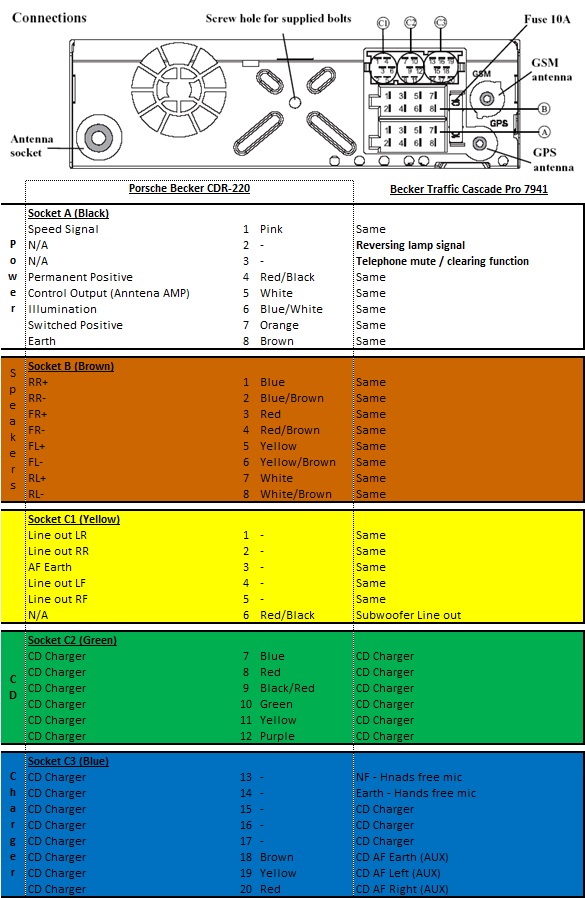

Hello all,
I recently tried to install a Becker headunit (7941 Cascade), which has the same wiring pinout as the OEM headunit (CDR 220 - Boss amp) ... at any rate when I installed the new Becker system, I did not get any sound but the headunit works.
I searched the forum but could not find anything that address this issue ... Please any help would be highly appreciated.

I'm not familiar with the Becker head unit, but... If it is like the Pioneer (which I installed), there are two types of output wires - speaker out and RF out (RCA connectors). If you are connecting to the OEM AMP, you would need to use the RCA plugs out of the head unit - you cannot plug the speaker out on your new head unit to the RF in on the existing AMP. On the other hand, if you want to bypass the Bose AMP, then use the speaker out, but you would need to wire directly to the speakers.
EDIT - The wires in the Yellow connector are the ones you need to connect to the RCA plugs is you are going to use the AMP (provided it does not require a security code for activation). Here is the wiring diagram for showing the connector:

Thank you for the wiring, but on my car I only have one wire in the yellow plug.
I attached a comparison between the OEM unit and the new one

I bypassed my AMP and found the sound was as good or better. The new head unit has a 4 X 60W internal amplifier. Trying to get a new head unit to work with the existing coded amplifier is impossible. Theft prevention is working against you on this one.

Attempting to use factory amp with aftermarket Jvc head unit. No sound coming out.
Is the Black/w/red stripe wire, (the only one i have), coming from the smaller yellow plug, my factory Amp Turn on? .. hence it should be connected to my head unit's amp remote/power antenna connection?

Yep solved. Give me about a week and i can send you a pic of my rough diagram i saved. Ultimately worked fine through the amp. Had to make sure i grounded the stereo alarm wire, so alarm wouldnt go off agter about 5 mins .
