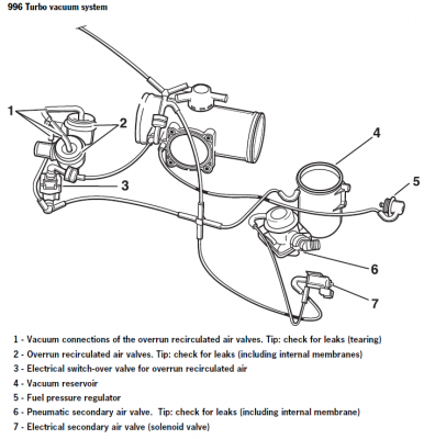

Ard has posted a great schematic depicting the engine vacuum routing.
The secondary air system begins functioning when the engine control unit electrically triggers on the secondary vacuum solenoid #7 when necessary.
That's when #6 air control valve is opened by vacuum allowing air which the electrical air pump creates (air pump not shown in above photo) to enter both bank 1 and 2.
Bank 1 Cylinders 1 thru 3
Bank 2 Cylinders 4 thru 6
A knowledgeable tech can diagnose this system sometimes very quickly with the use of a porsche tester by activating individual components without disassembly. The vacuum lines must be examined visually or with smoke tester for leaks.
