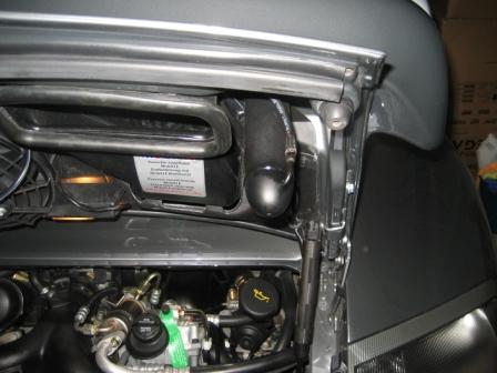

05-21-2009, 08:03 PM #94 vbmw335
Join Date: Dec 2007
Location: Chicago
Age: 32
Posts: 1,171
Rep Power: 64
I have attached the pics for reference. Just pull the blue wire behind the cylinder shove it behind the black wire and that's it...
Dont spend the money on harness ...it works great for me and has done for about a week now.

I just fixed mine.
But I just unplugged both switches from the ram. Ensured the springs were not depressed and tucked them away.
No more light and the spoiler also stays down.
