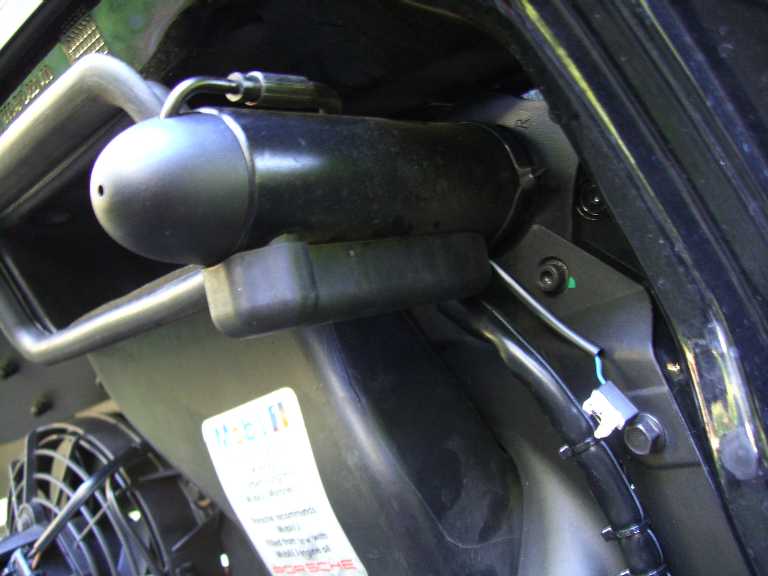

I have attached the pics for reference. Just pull the blue wire behind the cylinder shove it behind the black wire and that's it...
Dont spend the money on harness ...it works great for me and has done for about a week now.

Yes, thats it. vb's second picture shows the contact in question. I pulled both of mine out of the recepticle and let them hang free like that, but tucked them up under the plastic liner - out of sight. I put them in a plastic baggie with an elastic to keep them weatherproof, too.
Thank you very much sir. I look forward to trying this out on the weekend and will be happy to serve as another guinea pig for this test method (with my 2001 996 TT). Much appreciated for the great pictures...sending you meager reps now!

I took more pictures to share with the community when I did the work today. I used blue electrical tape and a zip-tie to secure the blue wire. I will test drive the car tomorrow morning, and will provide my findings here.

Well, I have a funny update to share. I performed the mod shown (and nothing else) and the wing still functions exactly as it always did. It goes up at 75 mph and back down at 37 mph, no change in behavior whatsoever. So now I'm a bit more perplexed as to what I actually unplugged...the engine cooling fan perhaps? No error codes are thrown, but it seems like I accomplished absolutely nothing so far. Any advice?

If those are your pictures above, then you disconnected the proper wire. I don't know about just disconnecting 1 connection, as I disconnected both the upper and lower connections. I would pull the other connector (the one that looks the same as the one you already disconnected) and try again. This is what I did and I do not have any lights with a fixed wing, but I do not have the rear spoiler installed, either - so I can't comment on that. Since these are the only two wires that attach to the wing hydraulics, I can not imagine it would function with both wires disconnected.
That's weird. Mine just stays up and no spoiler malfunction codes. In my case it did what i set out to do...which is to eliminate the malfunction codes and keep my spoiler up all the time.
Although i noticed that my right side cylinder is leaking some oil...my spoiler does not look like its fully raised. Need to check this,

I will pull the other connection and try again. Again, I'm surprised that it's working normally with the first "blue" wire pulled at all. Your electrical fan still works with this wire pulled, correct?
