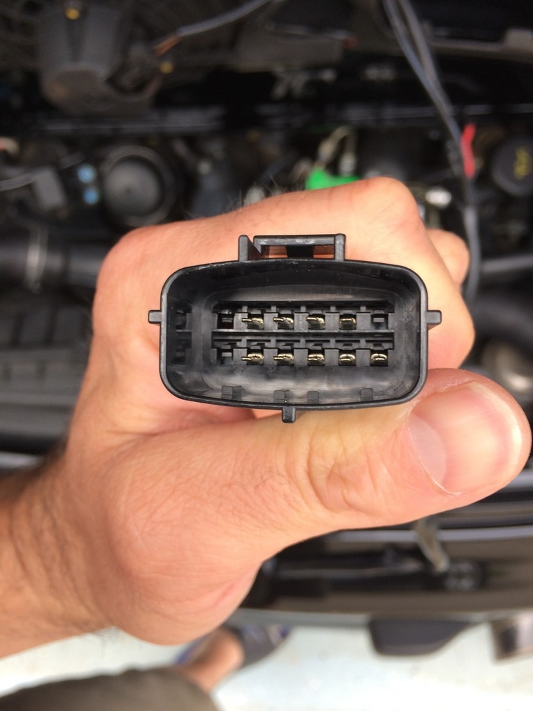

To remove the wire, pull the yellow cap and you will see the image below.
There are small tabs you need to deflect with a small screwdriver while pulling on the wire you want removed.
Pict of completed wiring (note this didnt work for me but in combination of the rennlist link from above did work).

Additional info for future people looking into this:
If you look at post #107 there is a comparison between the aerokit harness and the gt2 harness. I put a GT2 wing on my car and it came with a GT2 harness. I can confirm that the GT2 harness DOES create the spoiler warning. I can also confirm that jumping pins 2 and 5 on the GT2 harness solves the problem.
So for those sourcing harnesses instead of using the turbo harness, the GT2 harness is also an acceptable solution with some light modification. I pulled the pin from the engine light as it was not being used anyway and repurposed it to create the 2 - 5 bridge.
