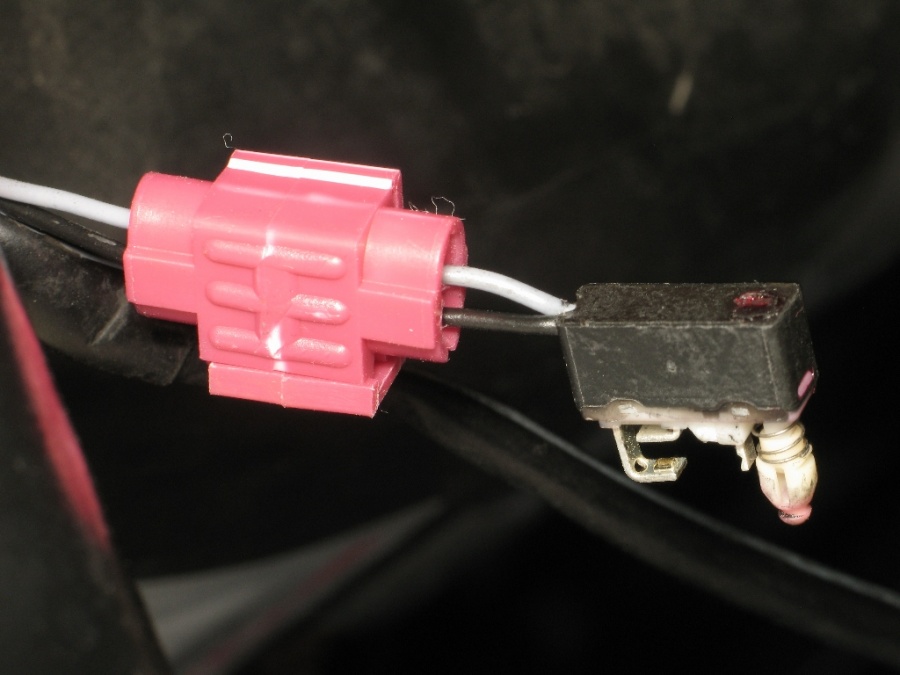

This fix stopped my spoiler failure warning light from coming on. I have a 2002 turbo. I installed a fixed height stock spoiler kit after my right ram failed. This basically entails removing the hydraulic pump, pulling out the microswitches, gutting the rams and shimming the stock spoiler up with lengths of tubing placed inside the rams. It maintains the stock spoiler appearance at the raised height. I did not remove the spoiler dash switch. The spoiler warning dash light always activated above 75 mph and stayed lit until the car was turned off. This was getting tiresome.

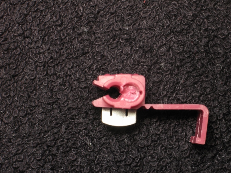

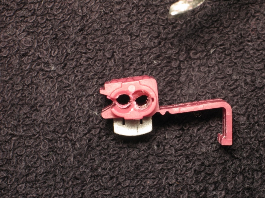

I used a quick splice connector to splice the black wire to the light grey wire going into one of the two microswiches that was attached to the right side ram. (IIRC this is the upper limit microswitch, as the wires to it off the harness is shorter. The other microswitch has a blue wire going to it. See photo.) Problem solved. One could also close that switch or cut the two wires and splice them to achieve the same result. No more warning light now after numerous runs above 75mph.
I enclosed some photos of the process. I had to modify a standard quick splice connector by drilling out the plastic on one side to allow both wires to pass through the connector. Hope this helps.

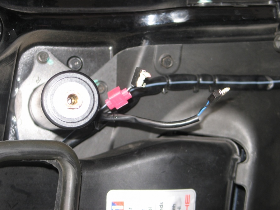

Hey guys. I have tried the fixes listed here and still getting this damn 'spoiler failure light'. I spliced both the upper and lower micro switches together. The light did not go away!
Here is a pic of what was done previously.. Not sure what do with this!
Thanks !!
