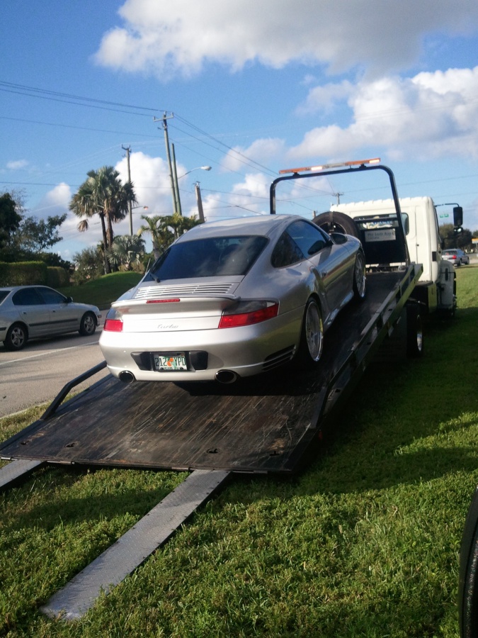

Oil sender failure must be in the air. While driving today, I hit a bump and the pressure dropped to 0 and the failure indicator lit up. As soon as I hit the next bump, everything went back to normal. I guess I'm going to be breaking in my extended warranty soon.

I dont know if the sender is related, but this is how my day ended.
The car lost power under throttle. When I lifted a little, it felt like it was coming back only to die completely. I had 1/4 tank of gas, so I had the wife bring me 5 gal just incase the gauge was off, but nothing.
I hope whatever it is is covered under my extended warranty!!!!
